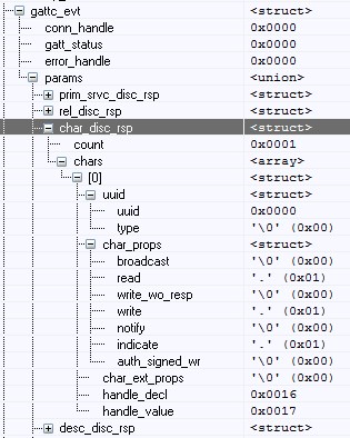

How to read 128uuid of characteristic ?
I try to use sd_ble_gattc_characteristics_discover(..) then wait BLE_GATTC_EVT_CHAR_DISC_RSP.
But uuid always 0x0000 according to the Photo:

I founf the answer. To discover the random 16 UUID of unknown characteristic I have to use
sd_ble_uuid_vs_add() if known 128 UUID vendor part
sd_ble_gattc_attr_info_discover() with Unknown vendor UUID, if S132 + nRF52 uses
