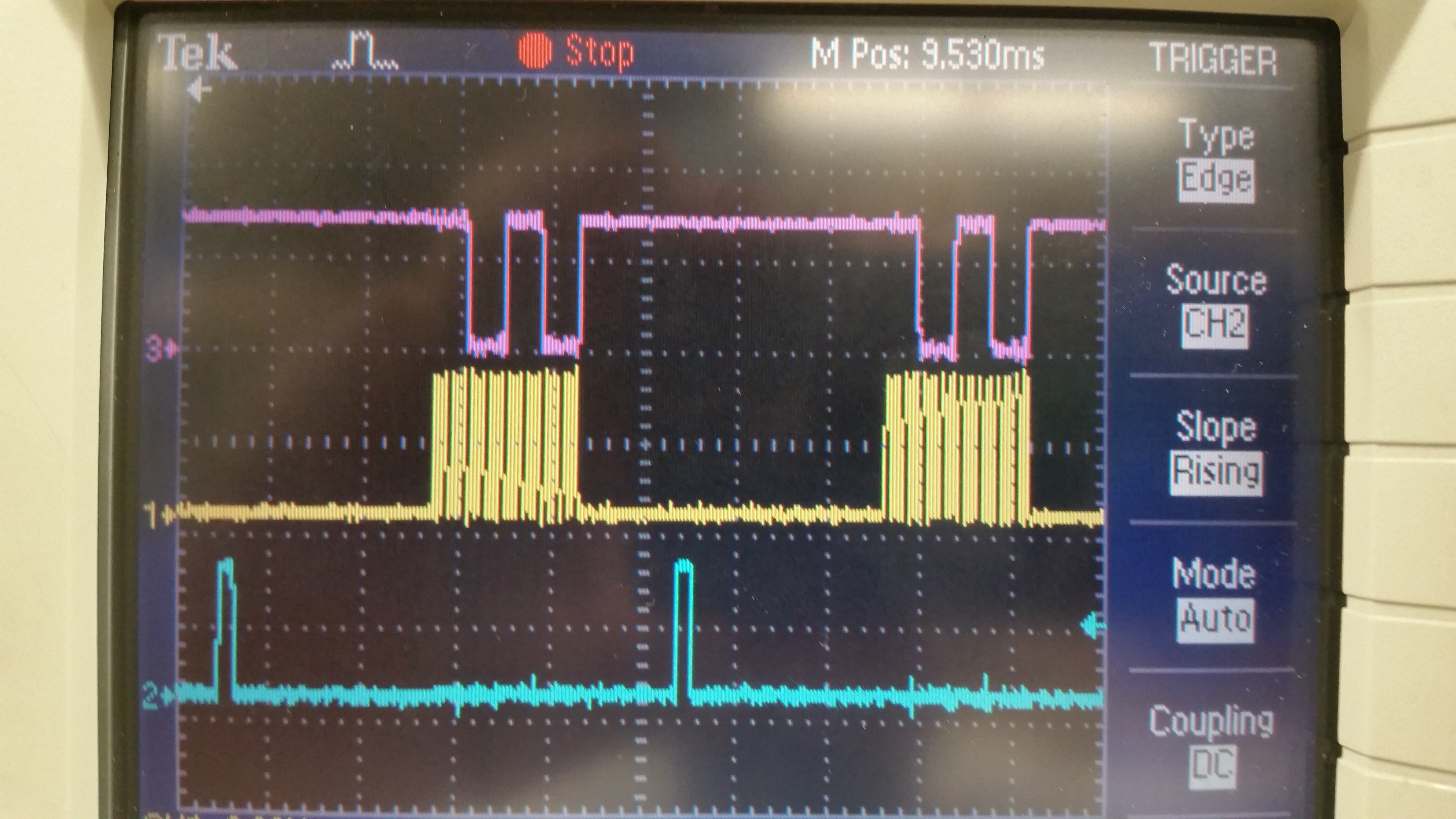

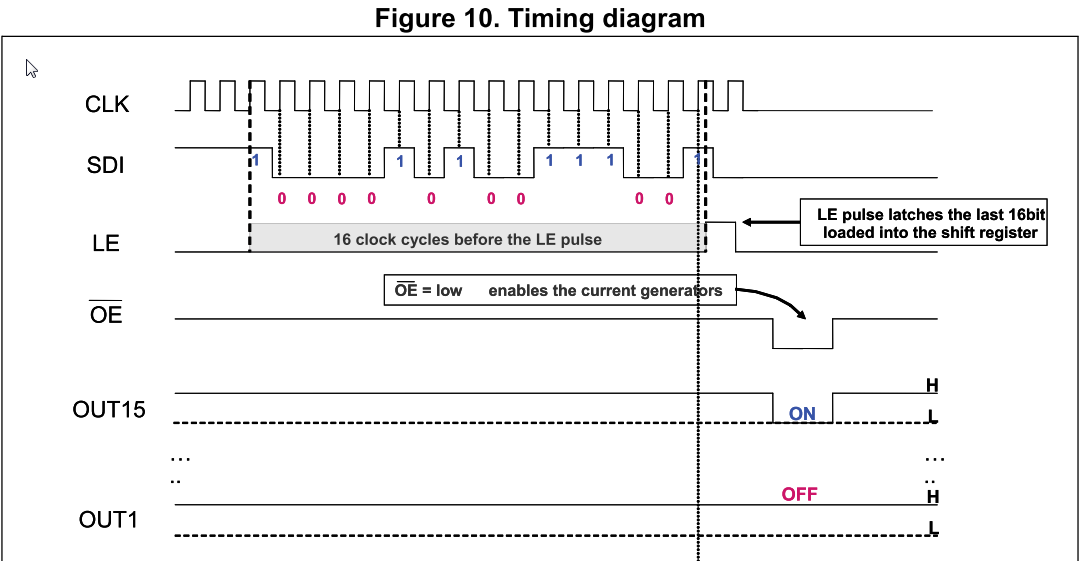

Hello, I am trying to interface the STPC16CPC26 with the NRF52832. As per the datasheet of the display driver, we have to toggle two IO pins from the NRF which shall be connected to the Latch Enable(LE) and Output Enable(OEn) for the data that is sent over by SPI to latch on the display driver, as shown in the attached file STP_TimingDiag.png. I tried using the sample SPI Code provided in the examples, and it works perfectly when I see the scope, I can see the clock and data signals correctly. The problem is I have to latch the data on the STP by sending a pulse from an IO pin on the rising edge of the 16th clock cycle, but I am unable to do the same. Could someone please help me as to how should I go about it, can I modify the existing library and do it, or do I need to write my own SPI routine.

    From the datasheet it looks to me like the pulse on LE is not happening on the rising edge of the 16th clock cycle, but rather after the 16th rising edge of the clock. I think the point is that you should wait until the SPI transfer is complete before you send the latch pulse, to ensure that the correct data is present in the SPI shift register (you should get this confirmed by STMicro).
    If you are using the SPI master driver, you will get a NRF_DRV_SPI_EVENT_DONE event when the SPI transfer is done. You can set the LE pulse in the event handler to latch the data after completion of the SPI transfer.

  • The clock is controlled by the SPI driver, so you will have to edit this, or use the SPI interface directly if you want to run the clock outside the SPI transfer. In the datasheet it is specified: Every rising edge of the CLK signal, a new data on SDI pin is sampled. This data is loaded into the shift register, whereas a bit is shifted out from SDO. If you run the CLK signal longer, you will clock out the data loaded into the shift register on the SPI transfer, so I don't think this is a good idea until you have enabled the LE, if you want to avoid data loss. Can you get confirmation from STMicro that you need the clock to be running when setting the LE signal, and that you have to set the LE signal exactly at the 16th rising clock?
