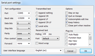

Currently i am trying BLE UART central (ble_app_uart_c) example without flow control. But its not work. My SDK is 11.0. I want to know the possible for ble uart work without flow control.
    First you will need to disable the flow-control. In the function uart_init() make sure you have APP_UART_FLOW_CONTROL_DISABLED. The function will then look like this:

    You must also turn off the flow-control in your terminal, and choose the correct baudrate.
    In Termite the settings would look something like this: image description
