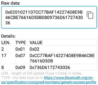

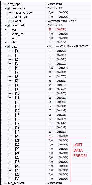

faced with a problem of S132 nRF52. ADV data of packet lost. I compared the RAW data according to screens below:
  1. If I use nRF Connect |Android tools, all works GOOD
  2. If I use nRF52 + S132, only limited ADV data received (sometimes randomly values)
nRF tools OK: image description
nRF52+S132: error (only first 21 bytes loads): image description
