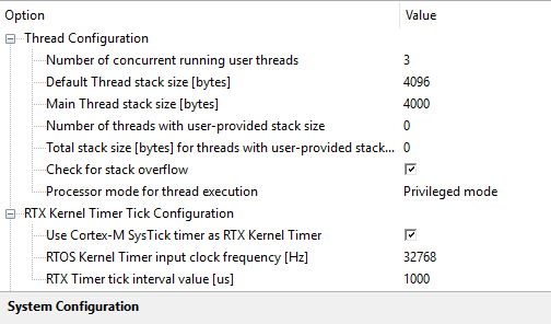

thread create successfully but on it get hard fault . i think after delay it get hard fault.
image description
all of my initialize is in main thread and all callback is in main() ; what is cause of hard fault?
