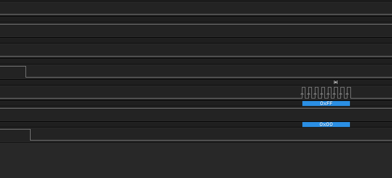

I'm using nRF52 + SDK11.0.0 + s132. I have an SPI slave configured. I have 40B data being read by a master every 12ms at 1MHz SPI clock. The master is trigger to do the read via a GPIO pin going LO and then HI after CSB is de-asserted. Every once in a while, the first byte transferred is a 0 where it should always be a 3 but the remaining bytes seem okay (they are not shifted; just the 3 was replaced by 0). This could happen in a matter of once every few minutes. I tried swapping the order of nrf_drv_spis_buffers_set() and the actual setting of the tx_buffer, but it doesn't help. Relevant code is below. Please advise.

Screen shot of MISO all 0s on the first (and only byte, since 0 signifies the master to stop reading). I confirmed that the remaining bytes by modifying the opcodes and not having 0 as the first byte stop the transfer in another test. image description
