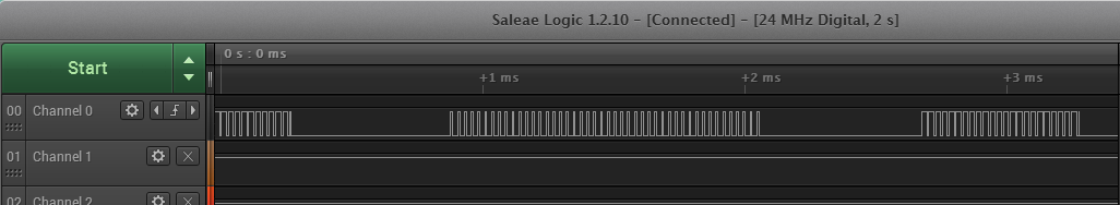

I have a problem with compilers for nRF51822. My problems: I create a pwm signal ~38Khz, duty 30% at pin 30 of nRF51822. This process is work well. I want use the function:
nrf_drv_gpiote_out_task_enable(pin)
nrf_drv_gpiote_out_task_disable(pin)

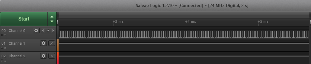

to Enable and Disable pwm signal to GPIO (pin 30). With Keil MDK is good (as the followd picture), but with gcc compiler is not good (as the second picture). I use SDK11, pwm_library example

Results with Keil MDK: image description
Results with ARM_GCC: image description
I do not understand why gcc_arm compiler is not good with my problems. Thanks for your watching!
  • Which optimization level are you using when you're compiling with GCC? It could be that the delays are optimized, i.e. removed. Could you try to set the optimization level to 0, i.e.
    CFLAGS +=  -Wall -Werror -O0 -g3
  • The followed code is a part of Makefile:
    #flags common to all targets
    CFLAGS  = -DNRF51
    CFLAGS += -DBOARD_PCA10028
    CFLAGS += -DBSP_DEFINES_ONLY
    CFLAGS += -mcpu=cortex-m0
    CFLAGS += -mthumb -mabi=aapcs --std=gnu99
    CFLAGS += -Wall -Werror -O3 -g3
