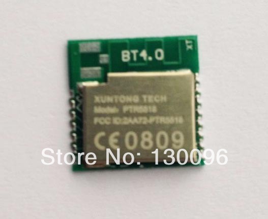

    here is the picture of module I'm using, it's name is PTR5518 eng V1.4 link text

    Another thing you have to check is which revision the chip is on the module. Could be that the chip was with revision 2 and won't support S130 v2.0 , please have a look here.
