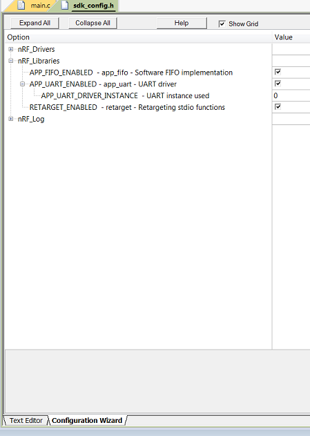

    You also need to configure the sdk_config.h file.
    You will need to have these defines:
    #define APP_UART_ENABLED 1
    #define APP_FIFO_ENABLED 1
    #define APP_UART_DRIVER_INSTANCE 0
    If you want to use printf(), you also need #define RETARGET_ENABLED 1

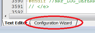

    If you use Keil, I recommend to use the "Configuration Wizard"
    image description
    You can enter the wizard at the bottom of the editor when you have sdk_config.h open. You can than quickly edit the sdk_config.h using this GUI wizard:
