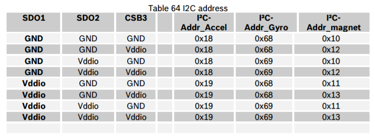

Magneto Address is 0x13.
But the values in tmpX, tmpY and tmpZ are all just 1; What are we doing wrong here?
Our other problem is the Gyrometer, we can access it just fine without the SoftDevice, but as soon as we try to access it with a softDevice, we get a NRF_DRV_TWI_EVT_ADDRESS_NACK error, what could be the problem here?

  • Again: thanks a lot for your support! We fixed the issue and I want to summarize how to connect the sensor to the board.
    The board we are using is called "Rigado BMD 300". www.rigado.com/.../
    The sensor we are using is called "Bosch BMX055". www.bosch-sensortec.com/.../bmx055 The sensor is connected with a breakout board made by a Company called MasterE.
    The correct I2C-connection is (master left, slave right): VSHIELD -> VDD (top left) | GND -> GND (bottom right) | PO.03 -> SDx | P0.28 -> SCx
    The two PO-pins must be declared as SC and SD in the firmware. As example we used TWI-Scanner (NRF 12). The scanner now recognizes the sensors. I hope this helps you. :-) Thanks again and keep up the great support.
