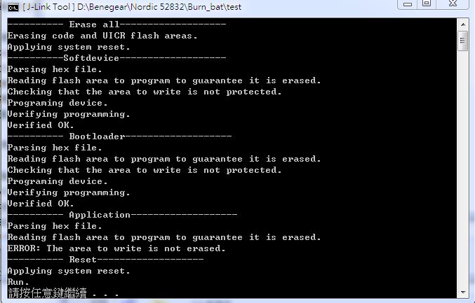

I try to using nrfjprog to burn softdevice + bootloader + applacation, but it shows that application burn failed. image description

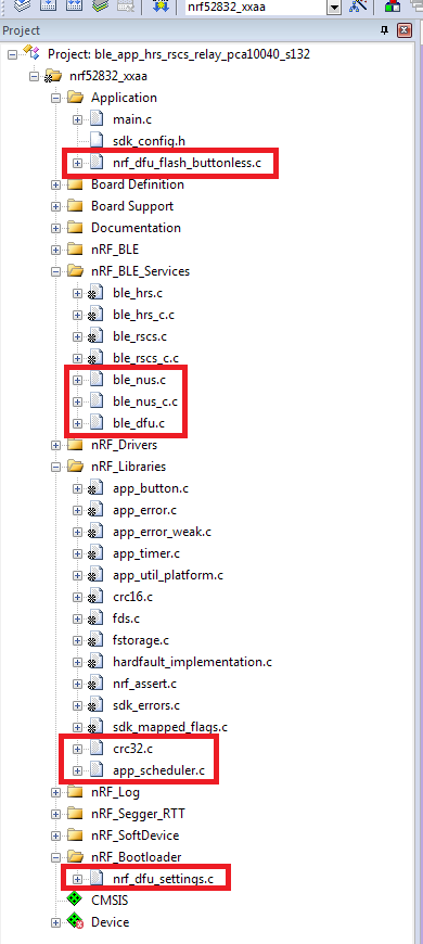

I add some file to the application project:
image description
I don't modify any file.
I did a test. If i remove the dfu c files(nrf_dfu_flash_buttonless.c, ble_dfu.c, _nrf_dfu_settings.c), it could burn success.

  • Hi Kevin,
    It was because a small bug with our buttonless approach. The nrf_dfu_settings.c file is used. It's the same file used for the DFU Bootloader and it will try to write to the UICR the address of the MBR setting page which is not needed for the buttonless application.
    When you use nrfjprog to program the application, it see that the address in UICR is already written and it won't be able to write to that area, throwing you the error.
    So what you need to do is to clone another file nrf_dfu_settings.c file and use it for the buttonless example (so that the DFU bootloader won't be affected), then remove the line 74 in the file, where we write to UICR:
