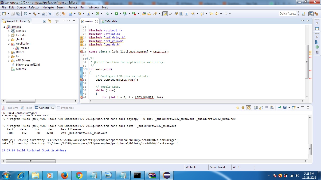

i am working eclipse for setting up projects for nrf52832. When i build the blinky example there is no error but the headers nrf_delay.h are not include and the LED_LIST are not detected ... plz help me

Take a look at this post (try to manually define the board in Eclipse). If you still have problems, see this post.
The error you are seeing with nrf_delay.h is just an issue with the autocompletion feature, where it's not properly parsing function implementations in header files. It's safe to ignore.
thanku sigurd .. but it is not working
Did you add BOARD_PCA10040 as a symbol with value 1 under Paths and Symbols?
Have you read the Development with GCC and Eclipse Tutorial ?
yes.. I added BOARD_PCA1004 in paths and symbols.. but it doesn't work
thanku ... now it is working ...
