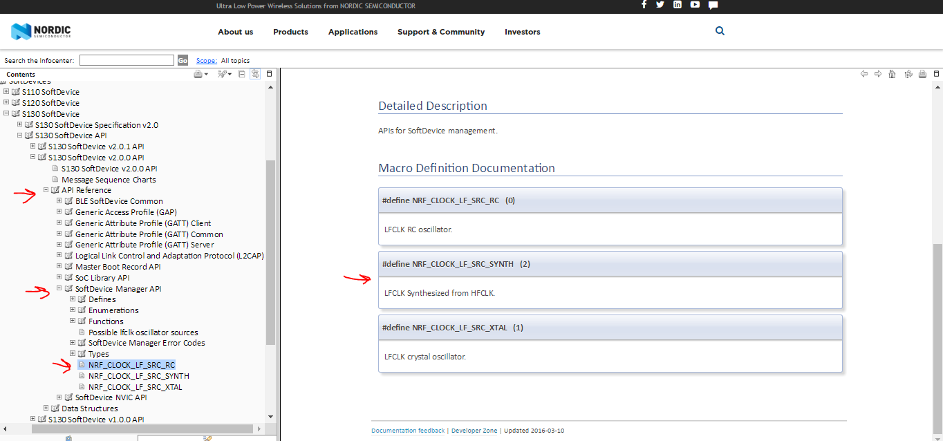

Hi i buy a nrf51822-02 module and the chip of this,is nrf51822qfaah10 i compile the ble_app_uart_s130 and program my module but it does not have any advertising
my nrfgostudio :
image description
my keil setting :
image description
i test my code and address on a nrf51822qfaca10 and it does not have any problem and advertise truly
i am sure about avdd,vdd,gnd and ....
i test 3 number of nrf51822qfaah10 and all of them has this problem
