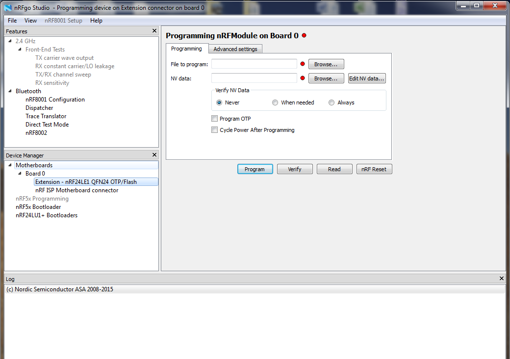

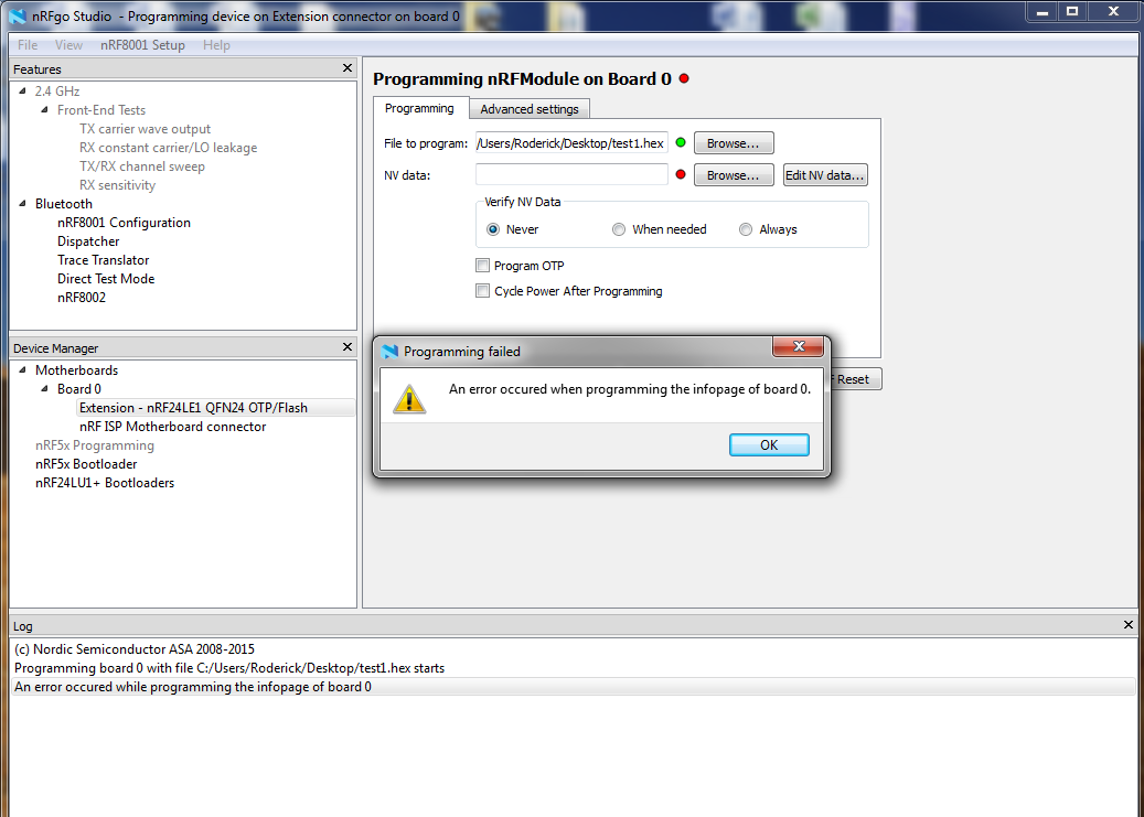

When i used board 0 extension board to program nRF24LE1 QFN24 OTP/Flash. it notification of error "An error occured when programming the infopage of board 0". What's that meaning ?
    Could you take a screenshot of the error and a photo of your setup ? Are you able to program other boards ? The nRF24LE1 OTP has not been programmed before ?
  • You can try to follow this instruction. It's for nRF24LU1+ but you can try with the nRF24LE1. Note that the OTP design is only one time programming.
  • Hi Hung Bui, I follow your instruction, but seems it cannot successful. Please advise what i can check, it keep notification me error on the infopage when programming nRF24LE1
    Infopage:
    Identifier (0x00-0x0F): 0x00 0x00 0x02 0x00 0x00 0x00 0x04 0x02 0x08 0x09 0x0A 0x03 0x00 0x0C 0x0C 0x0E
    NumberOfUnprotectedPages (0x20): 0xFF
    ReadDisableMainblock (0x23): 0x00
    EnableHWDebug (0x24): 0xFF

  • Have you programmed the chip before ? It could be that it has been programmed and won't be able to program again. Please try to test with another chip, prefer a normal , not OTP chip.
  • Hi hung bui, Yes, I try used the nRFgo studio + nRF24LE1 adaptor board to program on year ago and do not find any problem. But now, we used to program again and find error on info page. Do you have any technical support in HK or china that we can send our kit for them to fix the issue. Thanks Roderick
