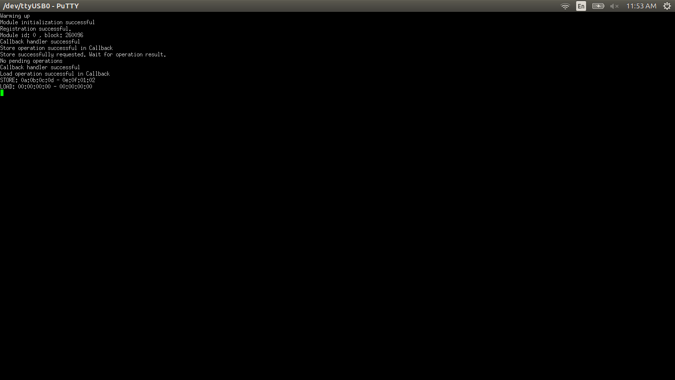

load error in pstorage data............?
hai i have this code to save and read some data in flash.but the stored and read data are not same. always reads zeros. how can i solve that.........?
here is my code

this is my output
image description
