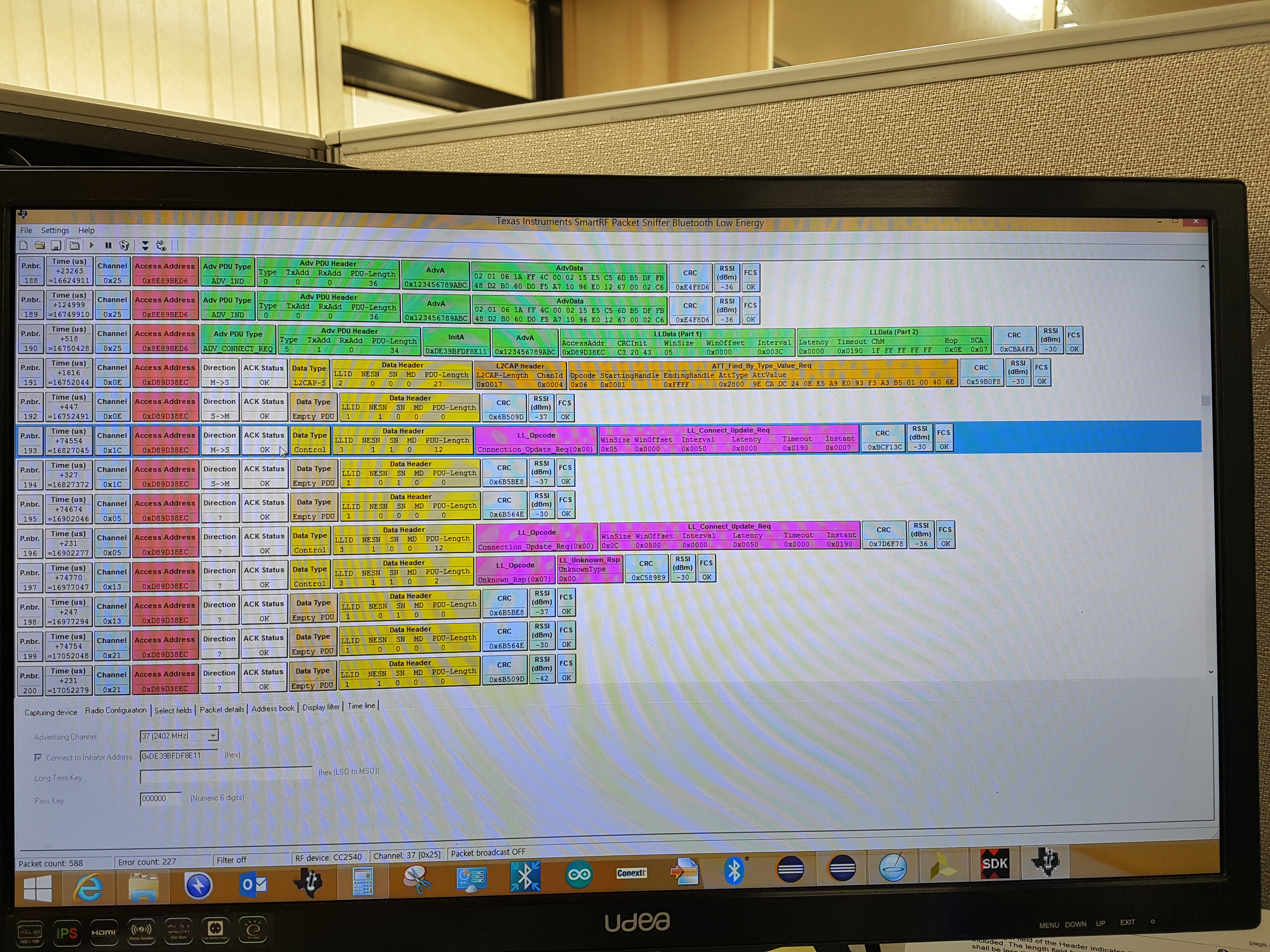

Abnormal connection update request PDU from slave
I'm working with a ble open source. Here i attached the captured abnormal case of the connection update Request PDU from the slave. Please refer to the attached picture. The slave shall not send the connection update request control PDU to master as i know.
Please feel free to tell me what you think about the abnormal case?
