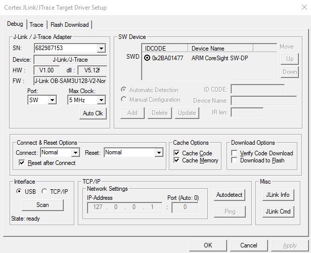

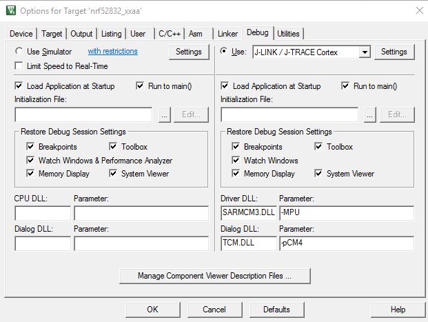

When I try to upload the .hex with the download button I get this error: "No ULINK2/ME Device found" and
Load "C:\\fichier\\ezzzz\\GIT\\openssss\\keil\\nRF52_SDK12.2\\openSWISS_ble_app_uart_RL_SDK12.2\\pca10040\\s132\\arm5_no_packs\\_build\\nrf52832_xxaa.axf"
Internal DLL Error
Error: Flash Download failed  -  Target DLL has been cancelled

  • For the second point of the question : option->debug for target was with wrong configuration. I don't know why it changes when I moved but right configuration is like that:
    image description
    image description
