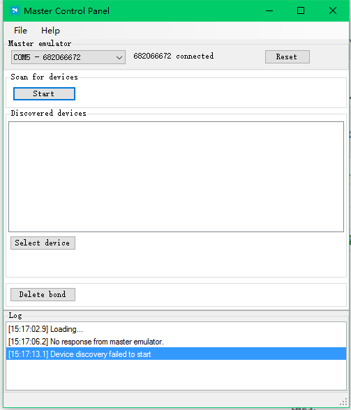

master control panel can not scan
Hi, Noric
When I use Master Control panel to connect my nRF52 for DFU, it shows:image description
Then when I press "Start", it shows:
image description
Plz help me.
Which example will be flashed on nRF52? central app or ble app?
or must be Dongle?
  • From other questions, I see:
    1.Master Control Panel only support nRF51 Dongle
    2.nRF51 Dongle need to flash program MEFW 0.11.0, File->Flash Programming, check current connected device support or not
    So, nRF52 can not be used, include DFU.
