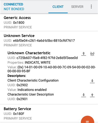

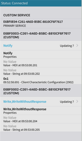

  • I am having exactly this problem; my code is essentially the same as above.  I don't know what I am doing wrong.
    What is happening is that the UUID of the data characteristic is the same as the UUID of the service.
    Here is what I am trying to achieve:
    Instead, I'm getting this:
    What am I doing wrong?

  • Your problem is that you're passing different UUIDs to sd_ble_uuid_vs_add().
    Try changing
    VERIFY_SUCCESS(sd_ble_uuid_vs_add(&m_scs_data_txchar_uuid128, &p_scs->data_uuid_type));
    to
    VERIFY_SUCCESS(sd_ble_uuid_vs_add(&m_scs_data_txchar_uuid128, &char_uuid.type));
    p_scs->data_uuid_type = char_uuid.type;
  • Andy,
    You are right, that was a bug (a vestige of previous attempts to solve this).  Thanks.
    Unfortunately, that doesn't fix the problem though.
    I am still getting the same UUID for the data characteristic as the service.
    --ken
  • I'm pretty sure that should have solved it. Try turning off and on airplane mode on your phone, or try rebooting it altogether. I know for a fact that iOS caches BLE services and characteristics and this cache is cleared in those cases. If you're on Android I'm not so sure how you can do that, but try something similar.
