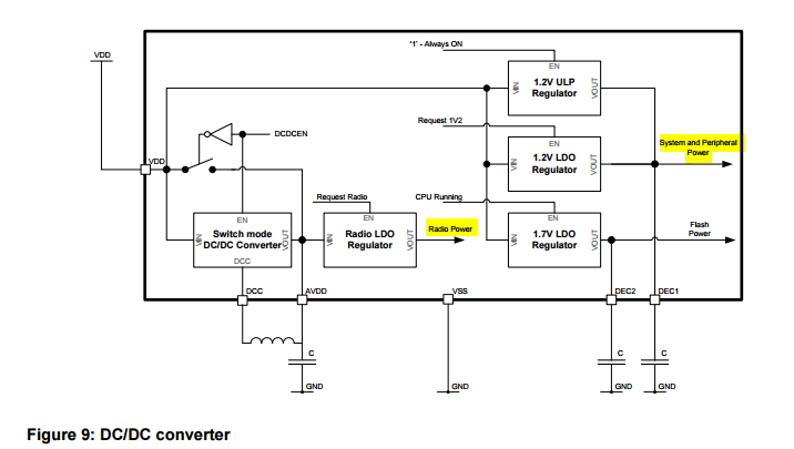

From reading the reference manual, product specification as well as searching the developer zone: here and here. Is it correct that the AVDD pin supply's ONLY the radio. AVDD does not supply the analogue peripherals ? (ADC,Comparator etc.) image description
