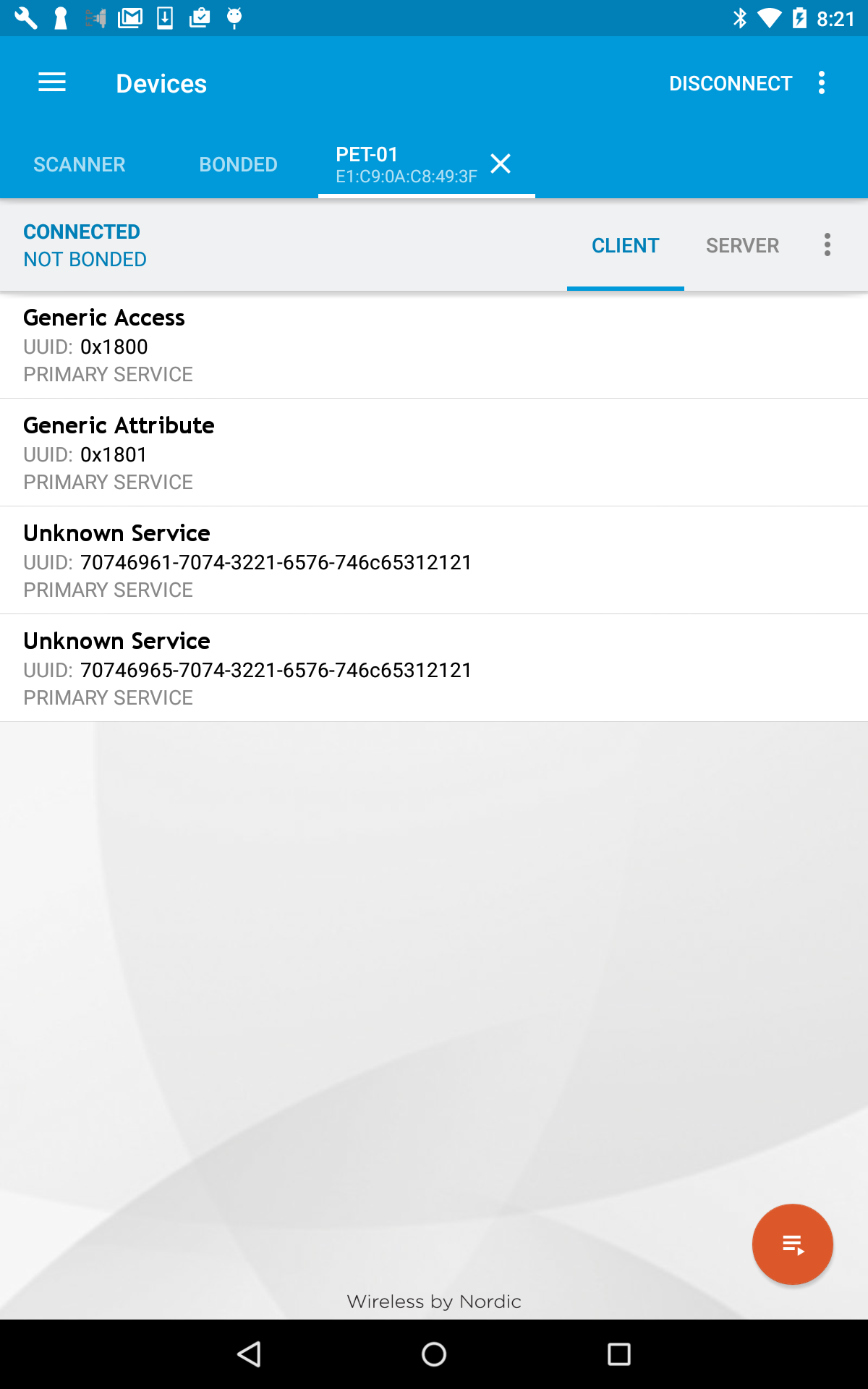

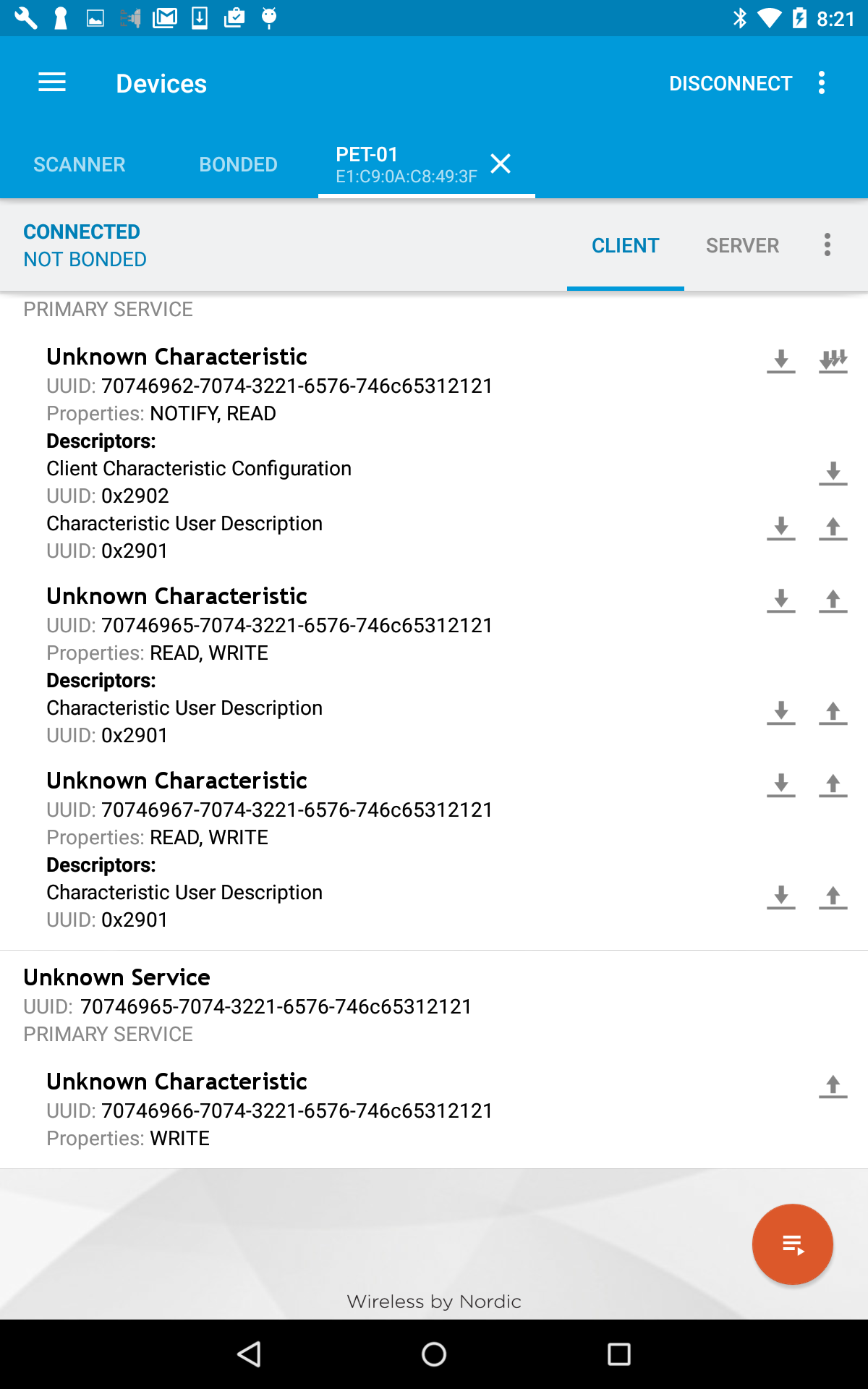

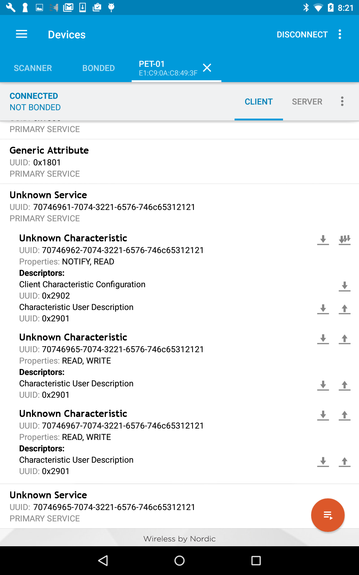

hello. Although example consumes less current when connected, in the project I made, consumption is not reduced even if it connects, what is the cause? The service seems to have completed communication normally. However, as far as the current consumption waveform is concerned, it seems that advertising is still continuing. Is there such a thing? Next I will attach the current waveform. It becomes 10 mA / 100 mV. image description
thanks. image description image description image description
