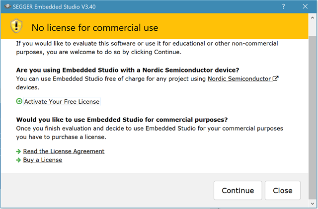

  • @rogerclark If you download SES V3.30, you should get this pop-up when you try to compile a project for the first time:
    image description
    Click "Get a Free License" button to register and get the free license. We have also made a youtube video that shows how to request your free license in your browser and add the activation key in SEGGER Embedded Studio.
    SEGGER license website: license.segger.com/Nordic.cgi
    Note that this was just released yesterday, so more information about this will be added in the next days/weeks.
