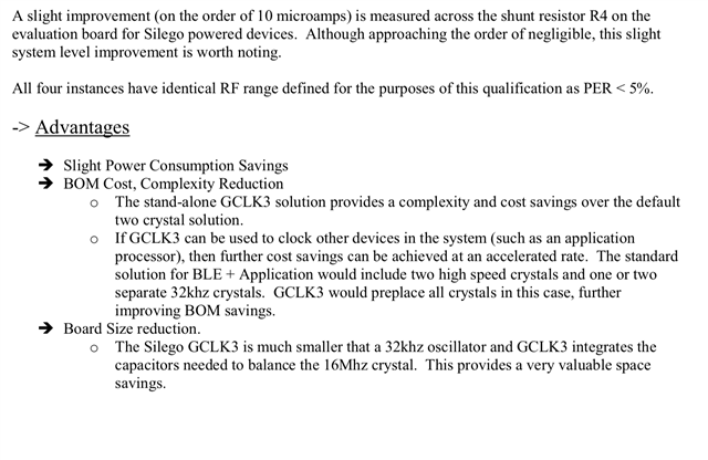

I'm looking for alternative xtal's (mhz + rtc) for use on boards where space is very limited.
Silego's GreenCLK3 looks like a great option, though that one is right now only available in a 26 MHz + 32.768 kHz combination.
They + SiTime have similar options, but I wonder if there are any RF-aspects that should be considered if using mems oscillators, like phase noise etc.?
