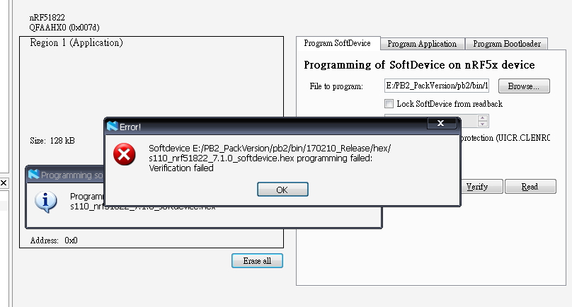

Hi, dear support team, I program the softdevice(S110,v7.1.0) to the nRF51822 devices(our product) by nRFgo Studio v1.21.1.3.
The nRFgo Studio shows a error message as below.
image description
Only one piece 100% failed and others are normal.
What it means?
Thank you so much.
  • Hi Stanley,
    Could you confirm, you have several custom boards (same layout) and on only one board you see the issue ? Could you check if you have the same error with nrfjprog and try "nrfjprog --recover" and then try to flash the softdevice with "nrfjprog --program" .
    If you simply flash an application without softdevice such as the blinky example, do you have the same issue ?
  • Hi Hung Bui,
    Thank you for the information.
    Yes, I have several custom boards and I see the issue on only one board.
    I have tried the command "nrfjprog --recover" and "nrfjprog --program", it seems normal.
    I have the same issue if I just flash the application with softdevice. The nRFgo Studio still popup the error dialog.
    There are some messages for your reference. Thank you so much.

  • So what you are telling is that the board was programmed and worked well if you use nrfjprog to program but it's not possible to program if you use nRFGo Studio ? Does the application work after you flash with nrfjprog ?
    Have you tried to call nrfjprog --verify to check if the hex is match ?
  • Hi Hung Bui,
    Actually, My board was programmed well but it doesn't work.
    I guess the ROM of nRF51822 was broken, right?
    I have tried to call nrfjprog --verify, It shows "verify failed".
    Let me show you the log below.
    C:\Program Files\Nordic Semiconductor\nrf5x\bin>nrfjprog.exe --verify E:/PB2_Pac
    kVersion/pb2/bin/170210_Release/hex/s110_nrf51822_7.1.0_softdevice.hex
    Parsing hex file.
    Verifying programming.
    ERROR: Write verify failed.
    Thanks!!
  • Has the board worked before ? Seems like an issue with the internal flash on the chip.
