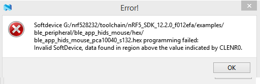

I just got an nRF52832 development board, I have ran the tutorials using Eclipse and I was able to run the blinky example.
I am now trying to get a BLE application to run. I am using SDK12.2, is this the latest one recommended for development on the nRF52832 with Eclipse by the way?
I flashed a soft device and application as follows:
>nrfjprog --family nRF52 --eraseall
Erasing code and UICR flash areas.
Applying system reset.
>nrfjprog --family nRF52 --program s132_nrf52_3.0.0_softdevice.hex
Parsing hex file.
Reading flash area to program to guarantee it is erased.
Checking that the area to write is not protected.
Programing device.
>nrfjprog --family nRF52 --program ble_app_hids_mouse_pca10040_s132.hex
Parsing hex file.
ERROR: The area to write is not erased.
I don't understand how the flash location is not erased, unless the softdevice and the application overlap. It is my understanding that the application runs in the user space which is separate from the softdevice.
Further to this: I tried using nRF studio to program the softdevice and the app. Programming the soft device went ok, similar to the command line tool. I got the following error while tying to program the aplication: image description
So this made me think that the application was actually bundled with a softdevice.
When I tried to program the application as if it was a softdevice I got this: image description
So what is it? I assume the hex files provided with the SDK are correct.
