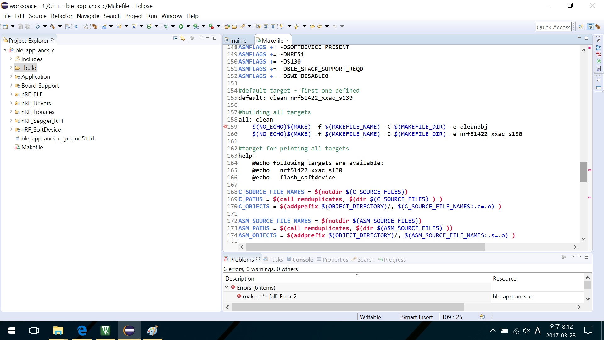

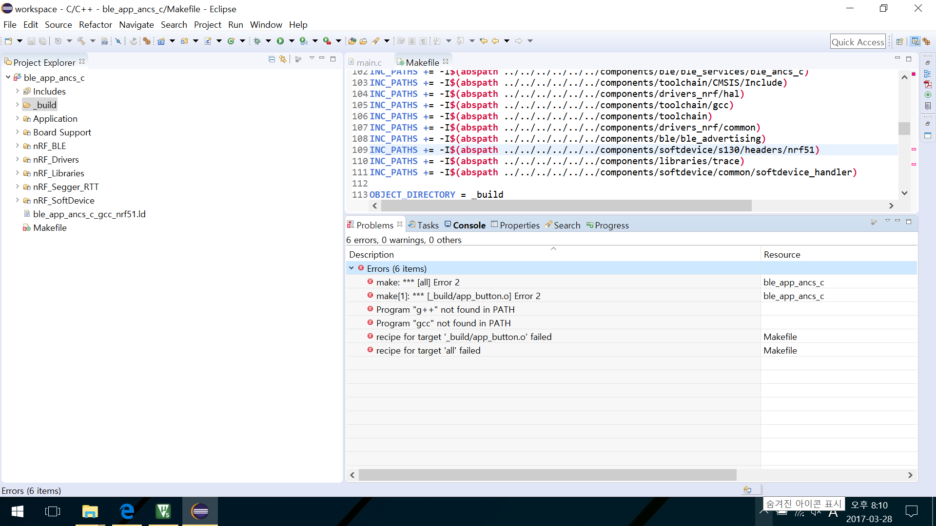

These messages are generated..!
I configured like this

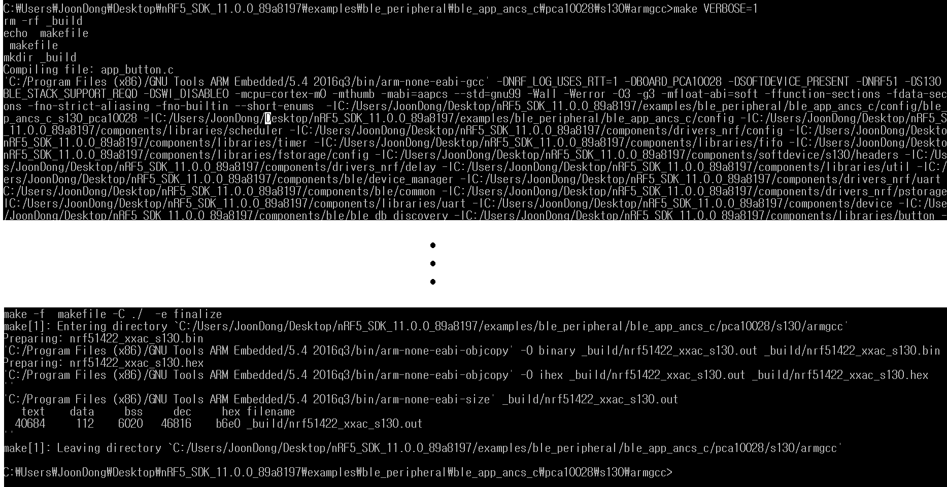

This is result of command prompt when I type make VERBOSE=1

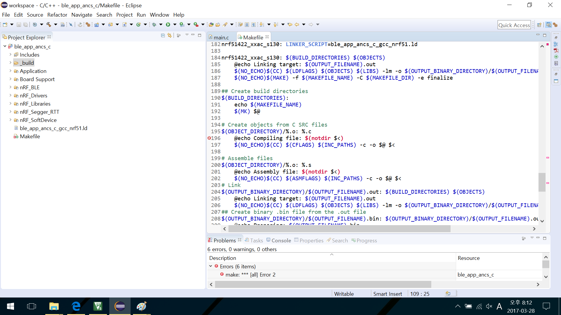

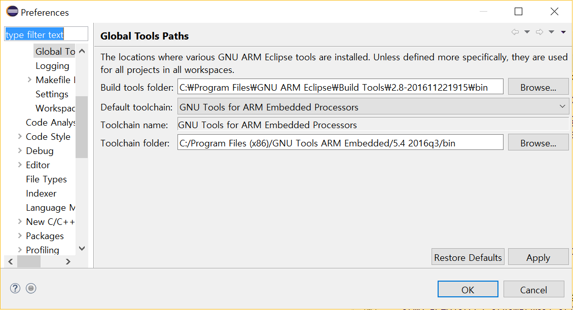

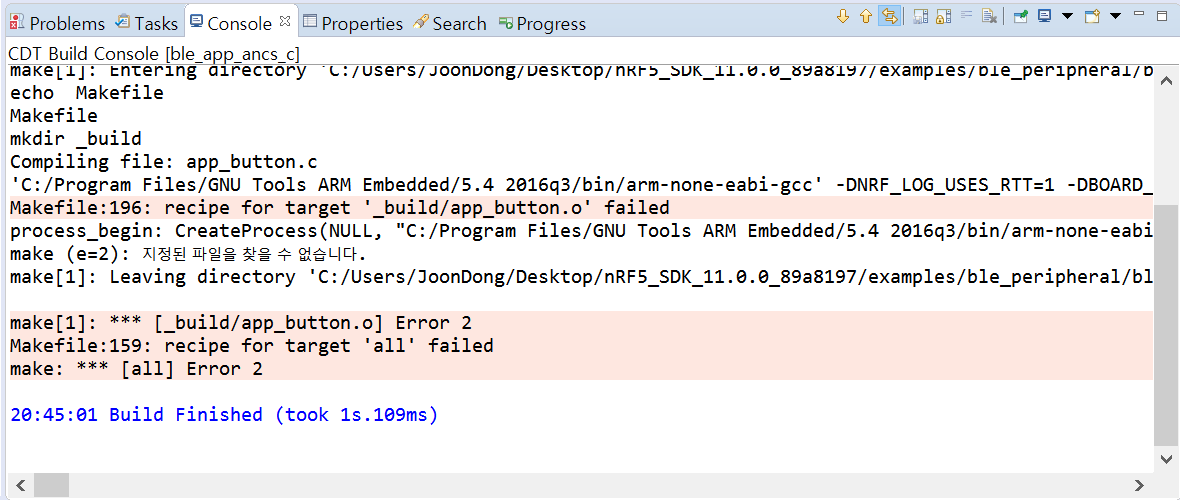

You seem to use an asian locale that does not use the \ as a path separator.
The error message is clear: CreateProcess (the windows function to run a program) cannot find C:/Program Files/[...] - note the wrong path separators here. CreateProcess() needs windows path separators to work.
You will need to replace the / in your "Toolchain Folder" setting. And you want to check whether this actually points to the correct location on your C: Drive.
I solve it. Thank you.
