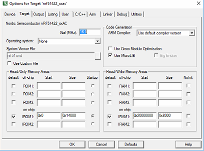

Hi, Forum. I want to make uart_bootloader without softdevice. for this, I want to prepare keil project. I tryed this but I have some problems.
Basically, My bootlader codes:
    #define APPLICATION_BASE_ADDRESS 0x14000
typedef void (*application_main_t)(void);
 * @brief Function for application main entry.
 application_main_t application_main = *(application_main_t *)(APPLICATION_BASE_ADDRESS+4);
	application_main();
Bootloader Rom and Ram:
image description

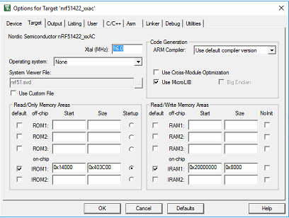

Application codes:
 int main (void)
	uint32_t err_code;
	bsp_board_leds_init();
	nrf_gpio_pin_toggle(22);
	nrf_delay_ms(500);
   nrf_delay_ms(500);
    lfclk_config();
	rtc_config();
	gpio_init();
	ADC_init();
    	ppi_init();
Application Rom and Ram:
image description
I load the bootloader first. secondly I load the application. Beginning of the bootlader, the main function is entering the LEDs are toggle. Then it does not work. The function that causes this is: lfclk_config();
I want to do something like this. What should I pay attention to. Are my Ram and Rom values correct? what should I do?
Note: The app is running on its own. (without bootloader) (Rom:0x000)
Thank you!
