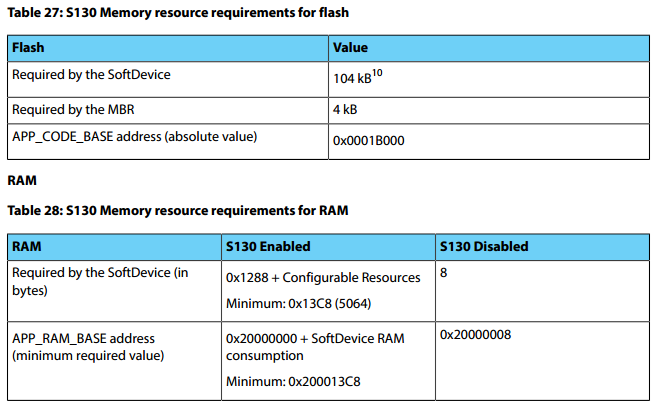

I'm using sdk12.2 which is using the s130 v2.0 soft device (2.0.1) and has the listed memory requirements shown on page 52 in infocenter.nordicsemi.com/.../S130_SDS_v2.0.pdf as follows image description

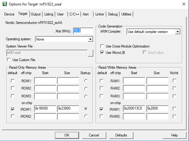

So I have set the following configuration for my project, image description
I now do not enter 0x00000000 upon crashing after a few main loops, but instead I crash right at the start when the following function is called and then checked.
err_code = softdevice_enable(&ble_enable_params);
the error is 0x00000004 and the program never is able to make a full loop.

Edit: I just stepped through the softdevice enable code and it is comparing the starting memory value against the expected value of 0x20001fe8 against my value I set. I originally started with this value in the project but since it wasn't in line with the documentation, I changed it. I have since adjusted and changed IRAM1 to 0x20001fe8 and size value of 0x1e98.
I am still crashing and entering 0x00000000.

    if your using a nRF51822 QFAA with 256 kB Flash and 16kB RAM with the S130 v2.0.1 then you will have 148kB Flash and at the most ~11kB RAM left for the application(if the SoftDevice uses the minimum required RAM). However, keep in mind that the RAM usage of the SoftDevice is dependent on the configuration you enable it with.
    If you're unsure if you've set the correct memory settings, then you can take a look at the The sd_ble_enable function, which is used to enable the SoftDevice. It will return the minimum start address of the application RAM region required by the SoftDevice for the given configuration in the app_ram_base variable. The value of app_ram_base will be printed on the UART/RTT if you have logging enabled. You can also open a debug session, set a breakpoint after the in softdevice_enable(ble_enable_params_t * p_ble_enable_params) function in softdevice_handler.c and examine the value of app_ram_base that way.
    Unfortunately, the S110 does not have this feature so finding the correct RAM start address is a process of trial and error, but setting it to 0x20002000 should for most applications be fine. You are correct that its not possible to set the start address to 0x20008188, as the nRF51822 QFAA only has 16kB, i.e. 0x4000 bytes of RAM. Could you explain how you calculated the IRAM1 Start address to be 0x20008188 based on the S110 documentation?
