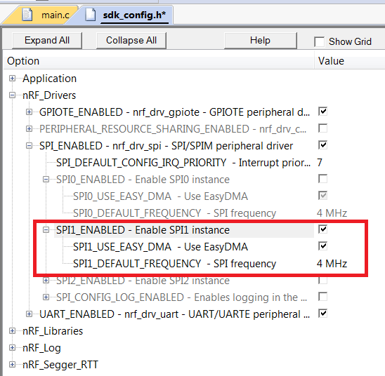

NRF52832 is SPI Slave, based on your examples/peripheral/SPIS/pca10040 sample SDK v12.2.0 board DK PCA10040 I am using instance 1. Instance 0 is not used.
Everything works except that MISO stays at 0 for the transfers duration. I see just some normal noise at the oscilloscope.
I have changed the pin for MISO, but it has no effect. Was pin P0.12, went to P0.25
I am sure that my tx buffer is non zero. It is aligned on 4 bytes boundaries (necessary ?)
The event system works well, I receive the frames from the master at high rate (every 250µs). There is 10µs between CS low and start of SPI clock. Changing the drive strength seemed at some point to show a very low level.
could this be due to a conflict of resources ?
  • I have solved the problem. It was a problem on my HW side.
