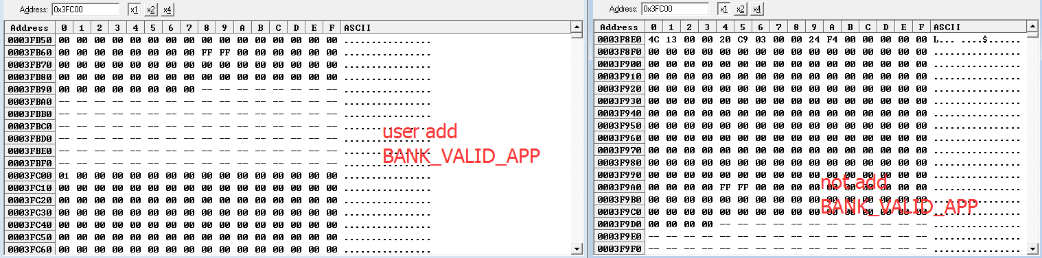

hello everyone: I use 1.sdk5.2.0 2.s110 6.0.0 3.51822AC BootLoader project IROM1 set(start:0x3C800 size 0x3400) application project IROM1 set(start:0x14000 size 0x2B000)
I want to combining s110_nrf51822_6.0.0_softdevice.hex,application.hex,BootLoader.hex.but appear ERROR:The hex files cannot be merged since there are conflicts.I guess maybe IROM1 in BootLoader project and application project is not correct set.I dot know how to set IROM1 in both project.who can help me? thx a lot!!!
