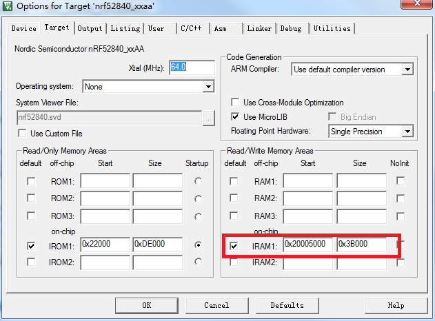

Compile, download code to nRF52840-PDK, but it doesn't work. The board can't advertising. I test my code in nRF51 DK and it works.
Where did i wrong? Can anyone help me?
/******************************Problem solved******************************************/
I am getting an error "No Memory for operation"(err code=4) when sd_ble_uuid_vs_add() is called. Reading the similar Questions in Nordic Dev Zone, i change the following code from ble_stack_init() in main.c.
default: ble_cfg.common_cfg.vs_uuid_cfg.vs_uuid_count = 0;
changed: ble_cfg.common_cfg.vs_uuid_cfg.vs_uuid_count = BLE_UUID_VS_COUNT_DEFAULT;
and then I get the same error "No Memory for operation"(err code=4) when softdevice_enable() is called.
I changed the IRAM1 Start and Size and this problem solved. image description
