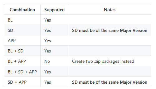

    For Q1, How can I make image files(*.zip file)? I want to know about NRFUTIL's Option after [nrfutil pkg generate].

  • Hi Roger,
    Q1: You can create combined images, e.g. SoftDevice+Bootloader, by combining the --application, --softdevice and --bootloader options. The allowed combinations are shown in the table below and is also displayed in nrfutil's documentation found here.
    image description
    So if you want to create a SoftDevice+Bootloader firmware image you use the following command
    nrfutil pkg generate --hw-version 52 --sd-req 0x98 --bootloader-version 0x11 --bootloader boot.hex --softdevice s132_nrf52_4.0.2_softdevice.hex --key-file priv_0407.pem sd_boot_dfu_package.zip
