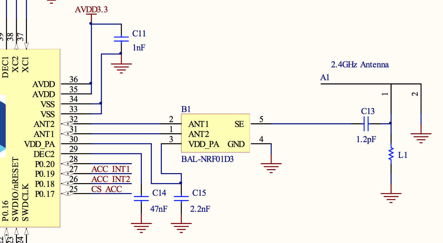

Hi, I have a custom board based around the nRF51822 which I programmed via SWD with the ble_app_hrs_pca10028_s130.hex image provided in the SDK, however when checking with the oscilloscope I see that there is no signal being outputted at the VDDPA pin, it is flat off. The same example on the nRF51-DK shows of course a good power signal at that pin when advertising. I have also tested other functions of the custom board like GPIOs and SPI and they work fine however the BLE section seems completely shut down. I'm not sure what could be the cause of the problem, I'm suspecting it's a hardware issue. I basically copied the BAL-NRF01D3 reference design and then used a PCB antenna, yet still get no power to the antenna, does anyone know what could be the issue here?
Here's the schematic for the custom board antenna section: image description

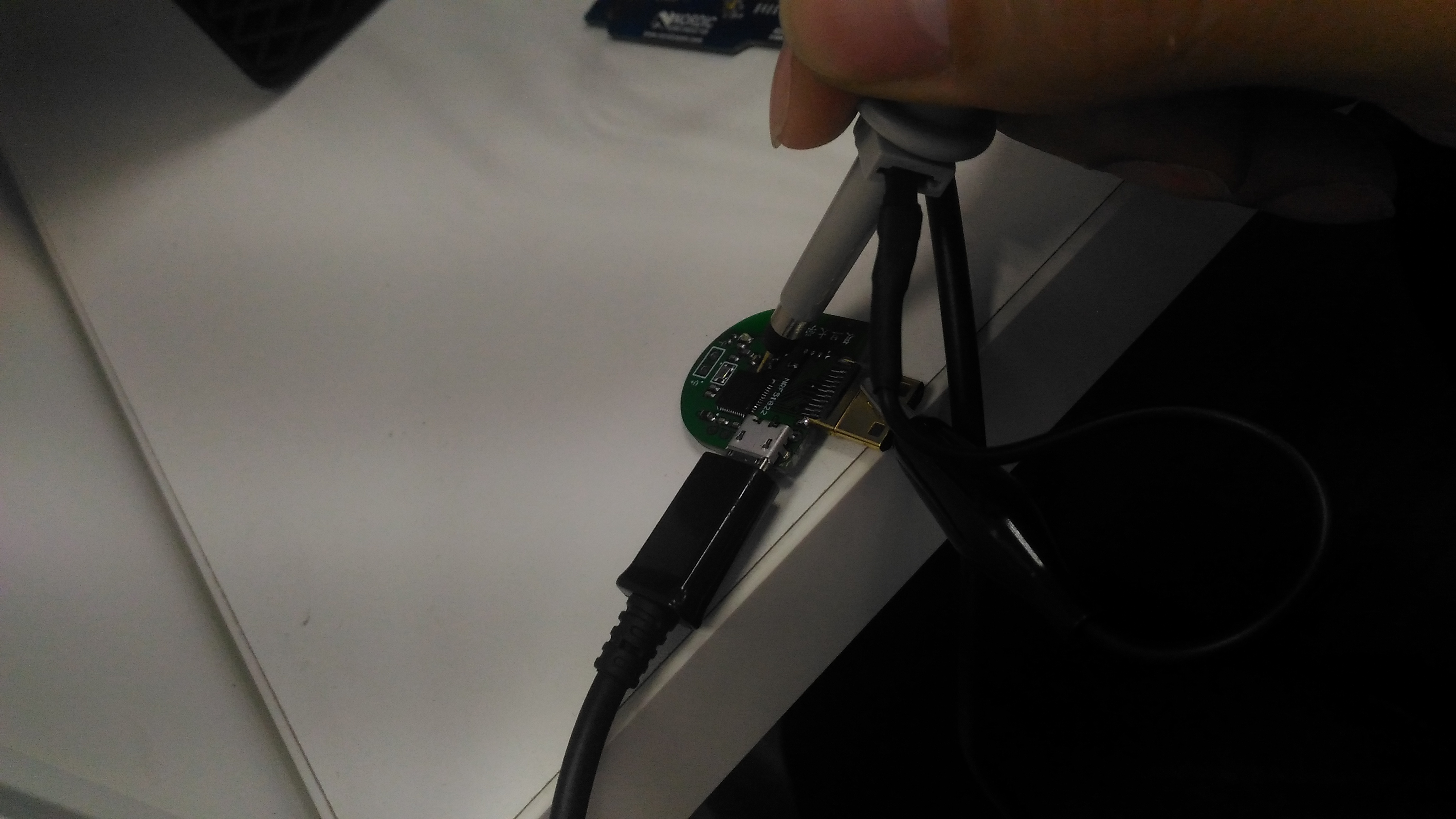

Checking VDDPA pin on custom board: image description

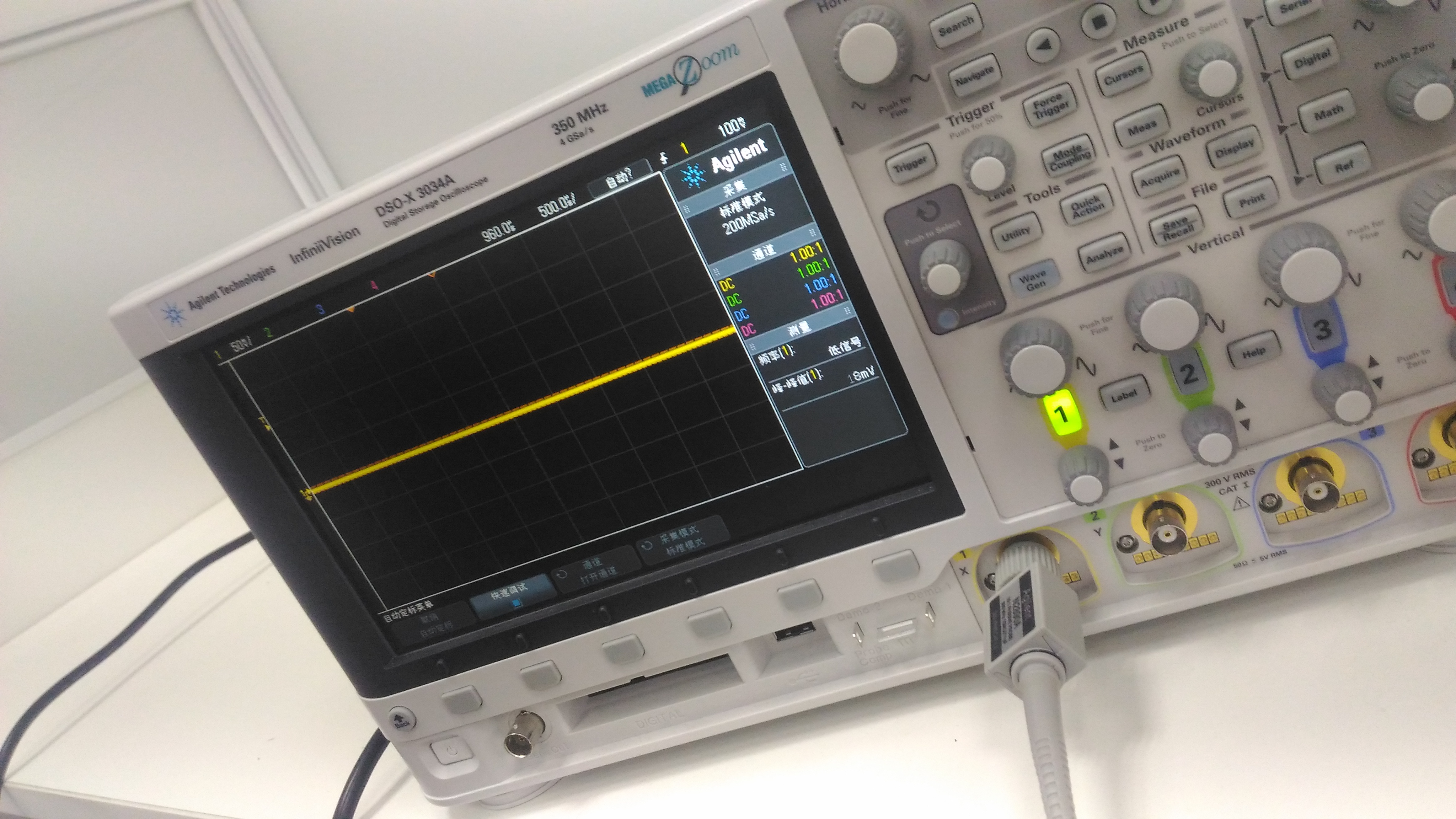

Scope output, flat: image description

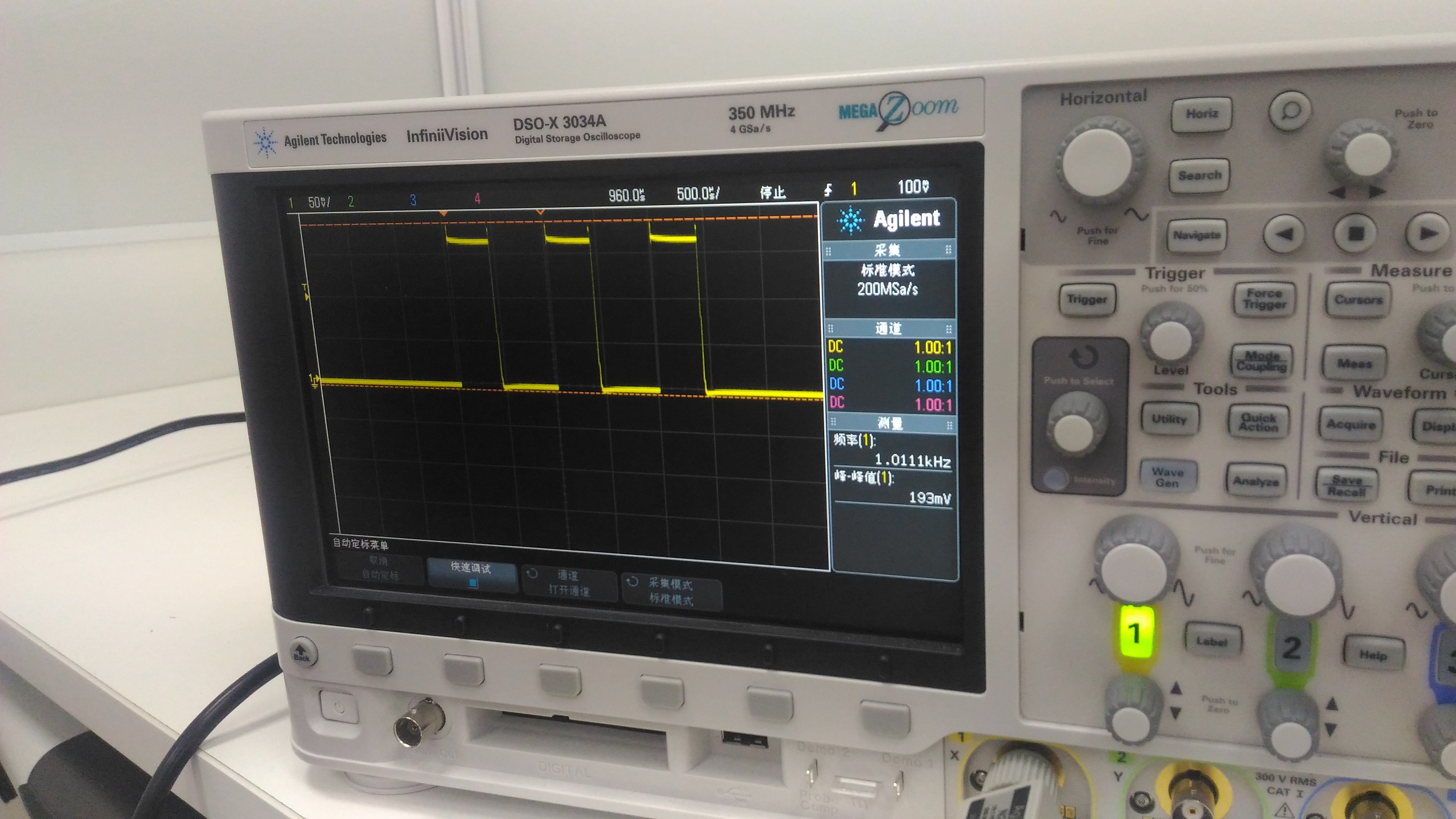

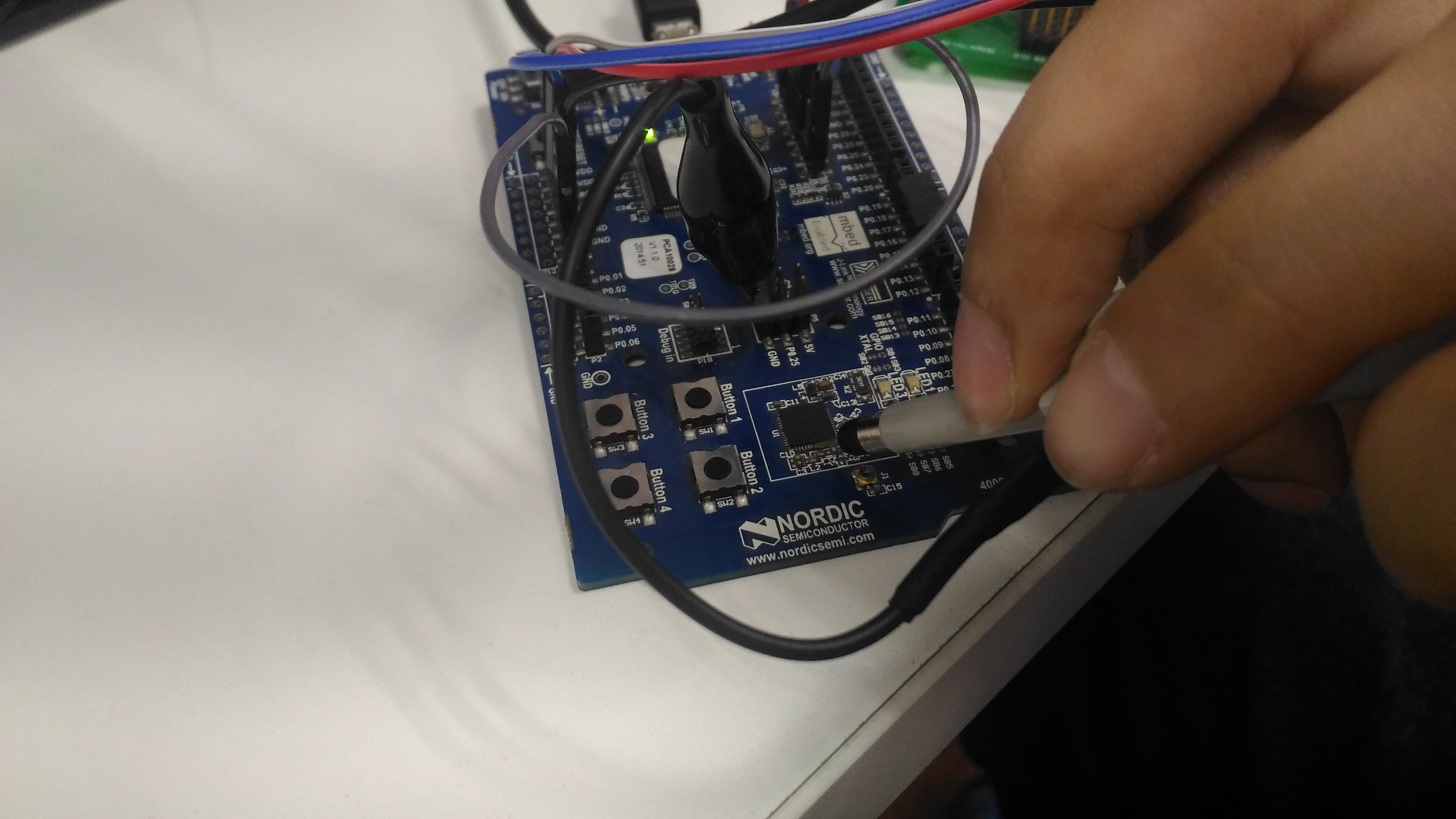

Checking VDDPA pin on nRF51-DK: image description
Scope output, OK: image description
  • Solved by configuring the clock LF source to the internal RC as shown here since the custom board doesn't have a 32.768kHz crystal. I also edited the RAM size linker script to accommodate 16KB (QFAA device on custom board). By the way I also noticed that I had to erase the whole memory, then program the S130 SoftDevice (make flash_softdevice), then upload the user application (make flash).
