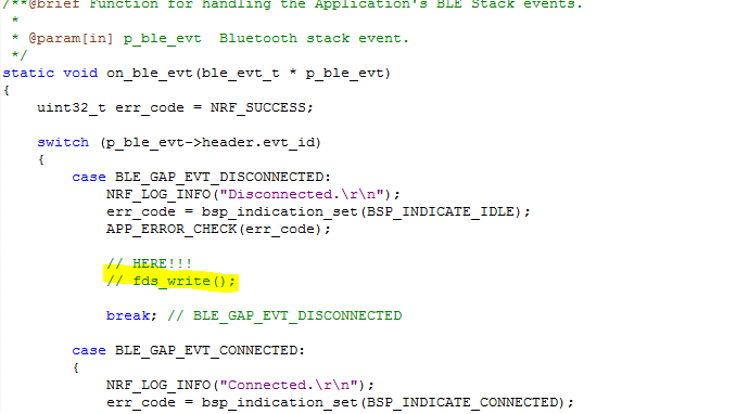

What I want to do is to store custom data to flash using FDS in "disconnected" event. image description
When I try to write the data in "disconnected" event, the write_flag is never raised. Is there any solutions to help me to solve this problem?
[Updated on 2017/4/25]
After some tests that I found the custom data is written successfully. However, the system does NOT work well because of the "while" function.

static void fds_write()
	uint32_t err_code;
		err_code =fds_test_write();
		//wait until the write is finished.
		while (write_flag==0);  // <<--------- Never leave this function.
		err_code = fds_read();
