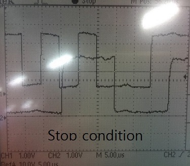

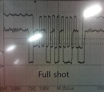

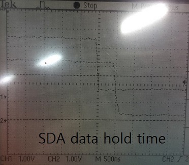

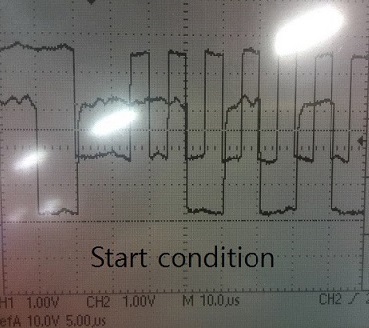

Always getting NCK.
I'm trying to control LSM6DS3 by TWI communication. Slave address of the chip is 0xD4 when SDO/SA0 pin is low.
I'm using SDK13.0.0.
My code is like below.
ret_code_t err_code;
uint8_t flag=0;
uint8_t *LSM_DATA;
err_code = twi_init();
while (true)
	twi_test();
	nrf_delay_ms(100);
	flag = 0;
twi_init()
const nrf_drv_twi_config_t twi_config = {
   .scl                = 4,
   .sda                = 3,
   .frequency          = NRF_TWI_FREQ_100K,
   .interrupt_priority = APP_IRQ_PRIORITY_HIGH,
   .clear_bus_init     = false
	err_code = nrf_drv_twi_init(&m_twi_master, &twi_config, NULL, NULL);
	nrf_drv_twi_enable(&m_twi_master);
	return err_code;
twi_test()
uint8_t slv_addr = 0xD4>>1;
uint8_t temp1 = 0x12;
uint8_t temp3[2] = {temp1, 0x00};
err_code = nrf_drv_twi_tx(&m_twi_master, slv_addr, temp3, sizeof(temp3), false);
return err_code;
It is almost similar to example code.(twi_sensor_pca10040) But I don't know why always NCK.
I checked hardware and TWI timing diagram and is correct.
Any help is greatly appreciated.
Oscilloscope capture image
