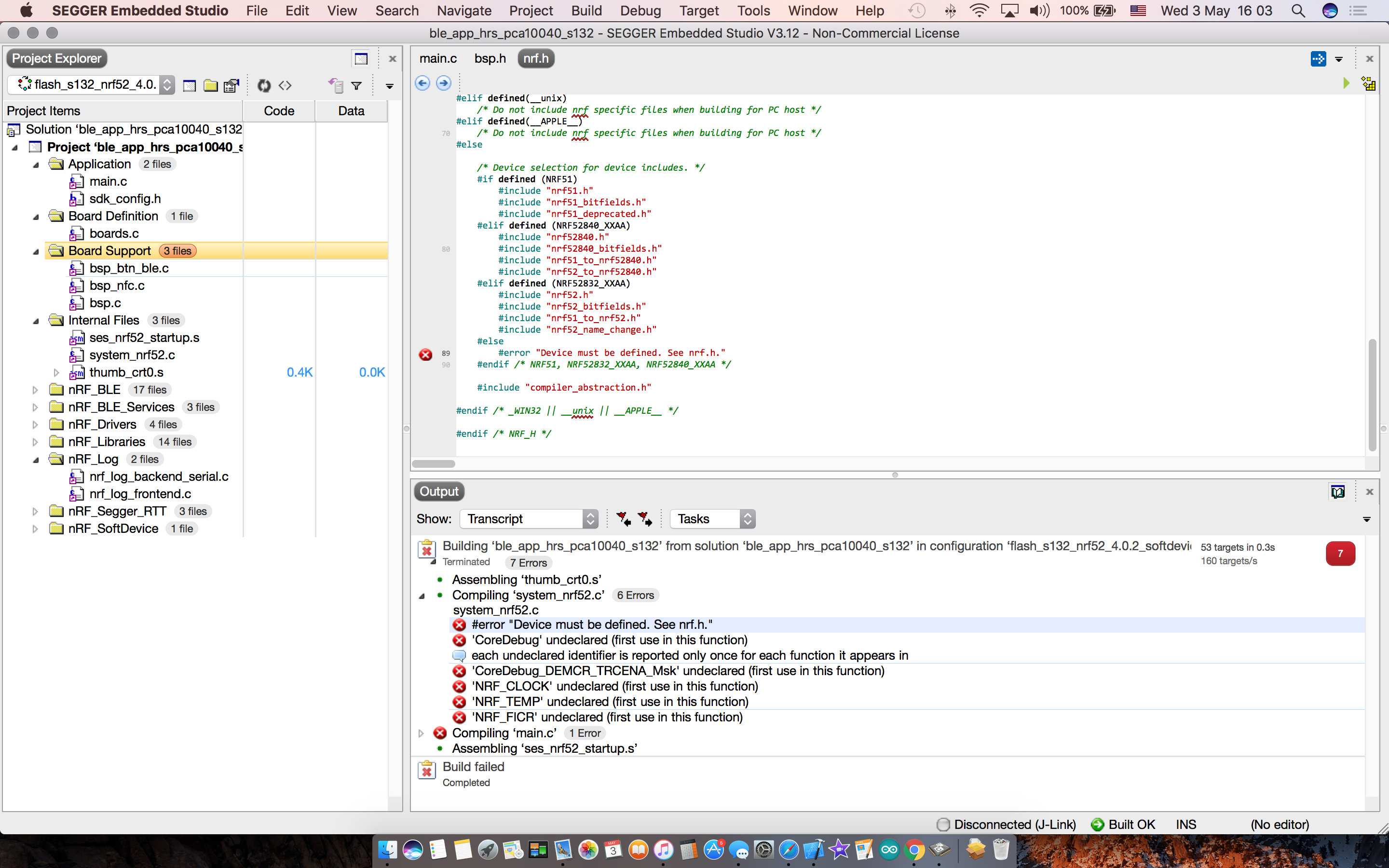

For a moment I was thinking that I made it with Segger, I was thinking that after 3 days with Eclipse with no success, I managed to use the blinky example and flash it (!)
Then it started. I was trying to use the blue_hrs new project, or even a template project, I use the guide from here , which worked with blinky but with any other project is not compiling.
Here are all the strange errors :

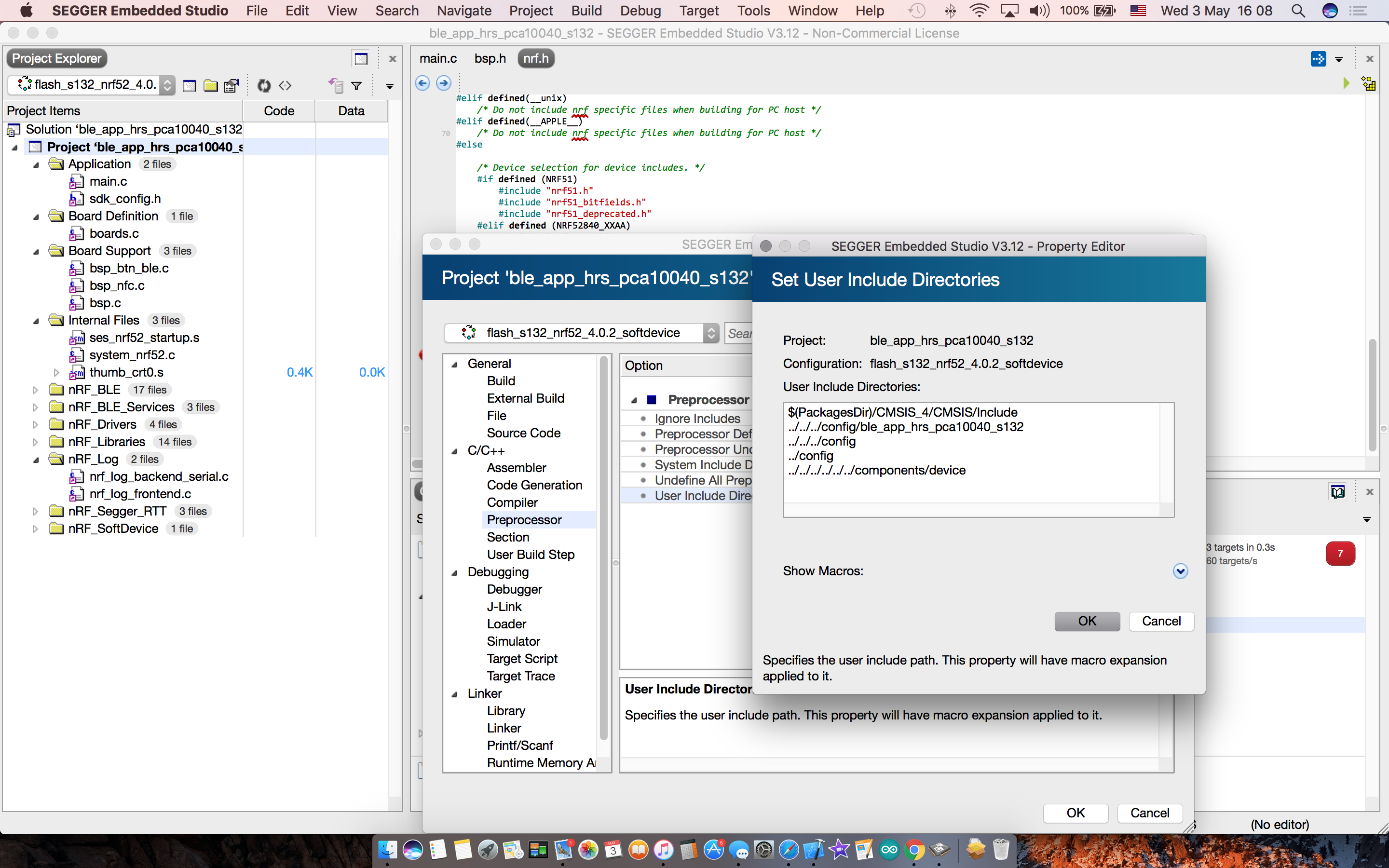

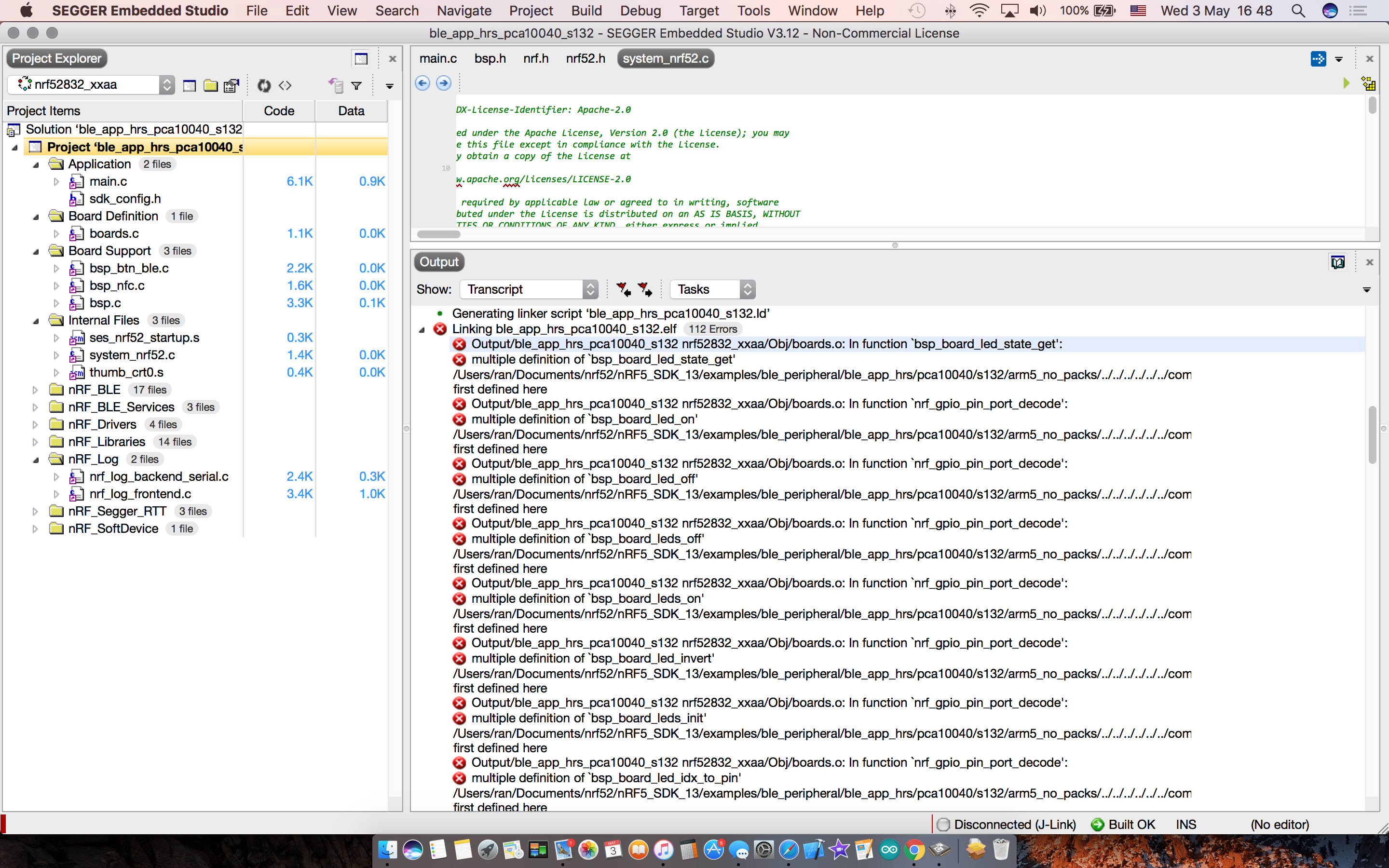

After adding what the comment said here I get all of these errors : image description
Under user included directories I have this :
../../../../../../components/device $(PackagesDir)/CMSIS_4/CMSIS/Include ../../../config ../../../../../../components ../../../../../../components/ble/ble_advertising ../../../../../../components/ble/ble_dtm ../../../../../../components/ble/ble_racp ../../../../../../components/ble/ble_services/ble_ancs_c ../../../../../../components/ble/ble_services/ble_ans_c ../../../../../../components/ble/ble_services/ble_bas ../../../../../../components/ble/ble_services/ble_bas_c ../../../../../../components/ble/ble_services/ble_cscs ../../../../../../components/ble/ble_services/ble_cts_c ../../../../../../components/ble/ble_services/ble_dfu ../../../../../../components/ble/ble_services/ble_dis ../../../../../../components/ble/ble_services/ble_gls ../../../../../../components/ble/ble_services/ble_hids ../../../../../../components/ble/ble_services/ble_hrs ../../../../../../components/ble/ble_services/ble_hrs_c ../../../../../../components/ble/ble_services/ble_hts ../../../../../../components/ble/ble_services/ble_ias ../../../../../../components/ble/ble_services/ble_ias_c ../../../../../../components/ble/ble_services/ble_lbs ../../../../../../components/ble/ble_services/ble_lbs_c ../../../../../../components/ble/ble_services/ble_lls ../../../../../../components/ble/ble_services/ble_nus ../../../../../../components/ble/ble_services/ble_nus_c ../../../../../../components/ble/ble_services/ble_rscs ../../../../../../components/ble/ble_services/ble_rscs_c ../../../../../../components/ble/ble_services/ble_tps ../../../../../../components/ble/common ../../../../../../components/ble/nrf_ble_qwr ../../../../../../components/ble/peer_manager ../../../../../../components/boards ../../../../../../components/drivers_nrf/clock ../../../../../../components/drivers_nrf/common ../../../../../../components/drivers_nrf/comp ../../../../../../components/drivers_nrf/delay ../../../../../../components/drivers_nrf/gpiote ../../../../../../components/drivers_nrf/hal ../../../../../../components/drivers_nrf/i2s ../../../../../../components/drivers_nrf/lpcomp ../../../../../../components/drivers_nrf/pdm ../../../../../../components/drivers_nrf/power ../../../../../../components/drivers_nrf/ppi ../../../../../../components/drivers_nrf/pwm ../../../../../../components/drivers_nrf/qdec ../../../../../../components/drivers_nrf/rng ../../../../../../components/drivers_nrf/rtc ../../../../../../components/drivers_nrf/saadc ../../../../../../components/drivers_nrf/spi_master ../../../../../../components/drivers_nrf/spi_slave ../../../../../../components/drivers_nrf/swi ../../../../../../components/drivers_nrf/timer ../../../../../../components/drivers_nrf/twi_master ../../../../../../components/drivers_nrf/twis_slave ../../../../../../components/drivers_nrf/uart ../../../../../../components/drivers_nrf/usbd ../../../../../../components/drivers_nrf/wdt ../../../../../../components/libraries/bsp ../../../../../../components/libraries/button ../../../../../../components/libraries/crc16 ../../../../../../components/libraries/crc32 ../../../../../../components/libraries/csense ../../../../../../components/libraries/csense_drv ../../../../../../components/libraries/ecc ../../../../../../components/libraries/experimental_section_vars ../../../../../../components/libraries/fds ../../../../../../components/libraries/fstorage ../../../../../../components/libraries/gpiote ../../../../../../components/libraries/hardfault ../../../../../../components/libraries/hci ../../../../../../components/libraries/led_softblink ../../../../../../components/libraries/log ../../../../../../components/libraries/log/src ../../../../../../components/libraries/low_power_pwm ../../../../../../components/libraries/mem_manager ../../../../../../components/libraries/pwm ../../../../../../components/libraries/queue ../../../../../../components/libraries/scheduler ../../../../../../components/libraries/slip ../../../../../../components/libraries/strerror ../../../../../../components/libraries/timer ../../../../../../components/libraries/twi ../../../../../../components/libraries/uart ../../../../../../components/libraries/usbd ../../../../../../components/libraries/usbd/class/audio ../../../../../../components/libraries/usbd/class/cdc ../../../../../../components/libraries/usbd/class/cdc/acm ../../../../../../components/libraries/usbd/class/hid ../../../../../../components/libraries/usbd/class/hid/generic ../../../../../../components/libraries/usbd/class/hid/kbd ../../../../../../components/libraries/usbd/class/hid/mouse ../../../../../../components/libraries/usbd/class/msc ../../../../../../components/libraries/usbd/config ../../../../../../components/libraries/util ../../../../../../components/softdevice/common/softdevice_handler ../../../../../../components/softdevice/s132/headers ../../../../../../components/softdevice/s132/headers/nrf52 ../../../../../../components/toolchain ../../../../../../external/segger_rtt ../config

  • Have you tried reading the error message? I don't see any strange error messages there, I see a nice big red X on exactly the line there's a problem .. let's see what it says
    Error: Device Must Be Defined
    The big red X error literally is on the right line in the header file and you can see that you only get there if neither NRF51 or two other defines are actually defined. So you need to set up some preprocessor definitions. That's in properties on the solution or the project or at quite a few levels, you need all those which were in the makefile.
