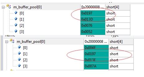

Why channel corresponding to the array is changed?
image description
#define SAMPLES_IN_BUFFER 4

  • When are the samples shifted? Are you using BLE in your application? What is the sample rate, and how do you trigger sampling? First thing you should try is to move the setup of the buffer in the callback, until after you read the buffer:

  • 1.Don't use the BLE
    2.E:\nordic\nRF5_SDK_12.2.0_f012efa\examples\peripheral\saadc

  • I don't understand your last comment. Did you try the change I suggested in my answer above?
