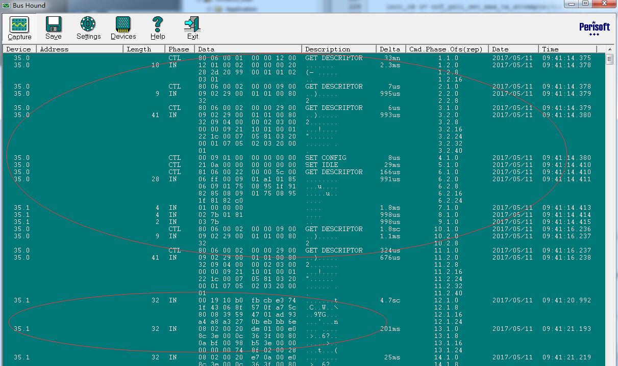

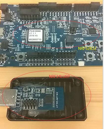

Use this routine E:\nordic\nRF5_SDK_12.2.0_f012efa3\examples\proprietary_rf\gzll\experimental\gzp_desktop_emulator To modify the can communicate with PC nrf24luep pairing, Communication data fetching use BUSHOND

Above GZLL agreement in gzp_desktop_emulator this routine can be used in matching and communications, Use this experimental_ble_app_gzll routines in the also not line, but don't know why, troubled for a long time

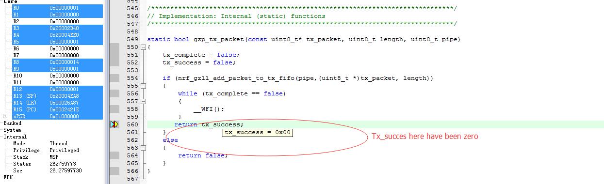

There is no matching success in experimental_ble_app_gzll this routine. So always here
while(!system_addr_received)
      system_addr_received = gzp_address_req_send();
      nrf_delay_ms(10);
image description
Tx_succes here have been zero,Pairing is not successful. Using NRF5_SDK12. 2 experimental_ble_app_gzll GZLL matching function is added to the routine. E:\nordic\nRF5_SDK_12.2.0_f012efa3\examples\multiprotocol\experimental_ble_app_gzll
