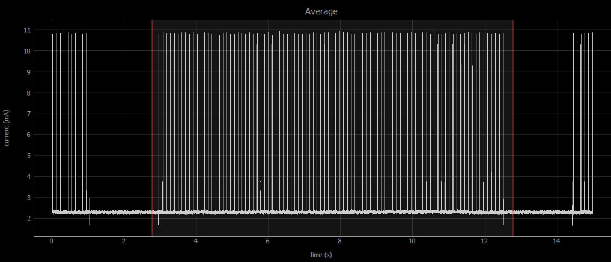

    I have written a test app that continuously advertise for 10 seconds, then it stops for 2 seconds and then starts again.
    image description

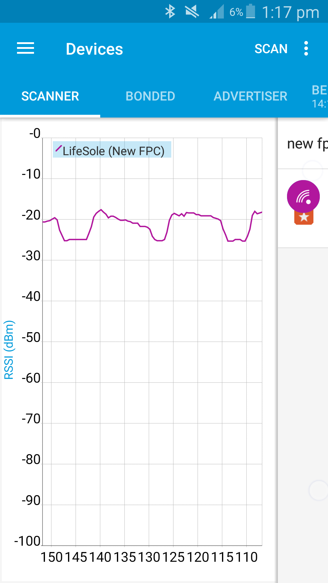

    With Power Profile Kit (picture above) I can see that the advertising last for 10 seconds as expected. Then after 2 seconds gap, it started advertising again as expected. Instead using the nRF Connect app, I can see the 10 seconds advertising sessions, and a kind of gap in between. But I was expecting nothing to be transmitted in between.
    image description

    Regarding the photo you posted, you see in the PPK image that in the 2 seconds gap the current consumption is about 2mA, the RADIO uses at-least 6-7 mA when transmitting, so it's impossible that it’s still advertising in that 2 second window.
  • Yeah, that was my understanding as well. But how can the nRF-Connect's RSSI-graph be explained then?
