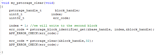

Hello, I am using pstorage function and I would like to know oppionions of your's what would be the best practise to wait until processor erases the flash memory and would ready for other actions? How should I know the process have been done?
here is the clear function: image description

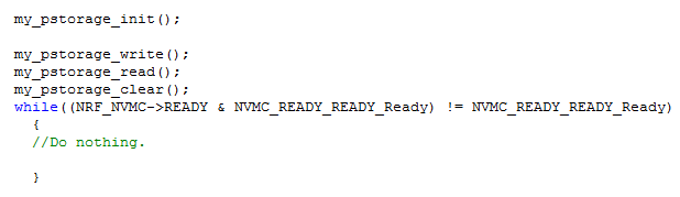

here is how I use it: image description
I am thinking that NRF_NVMC->READY register is never being busy (it's value never =0). Is it possibile, because if try to turn LED while NRF_NVMC->READY is busy it never turns on.
