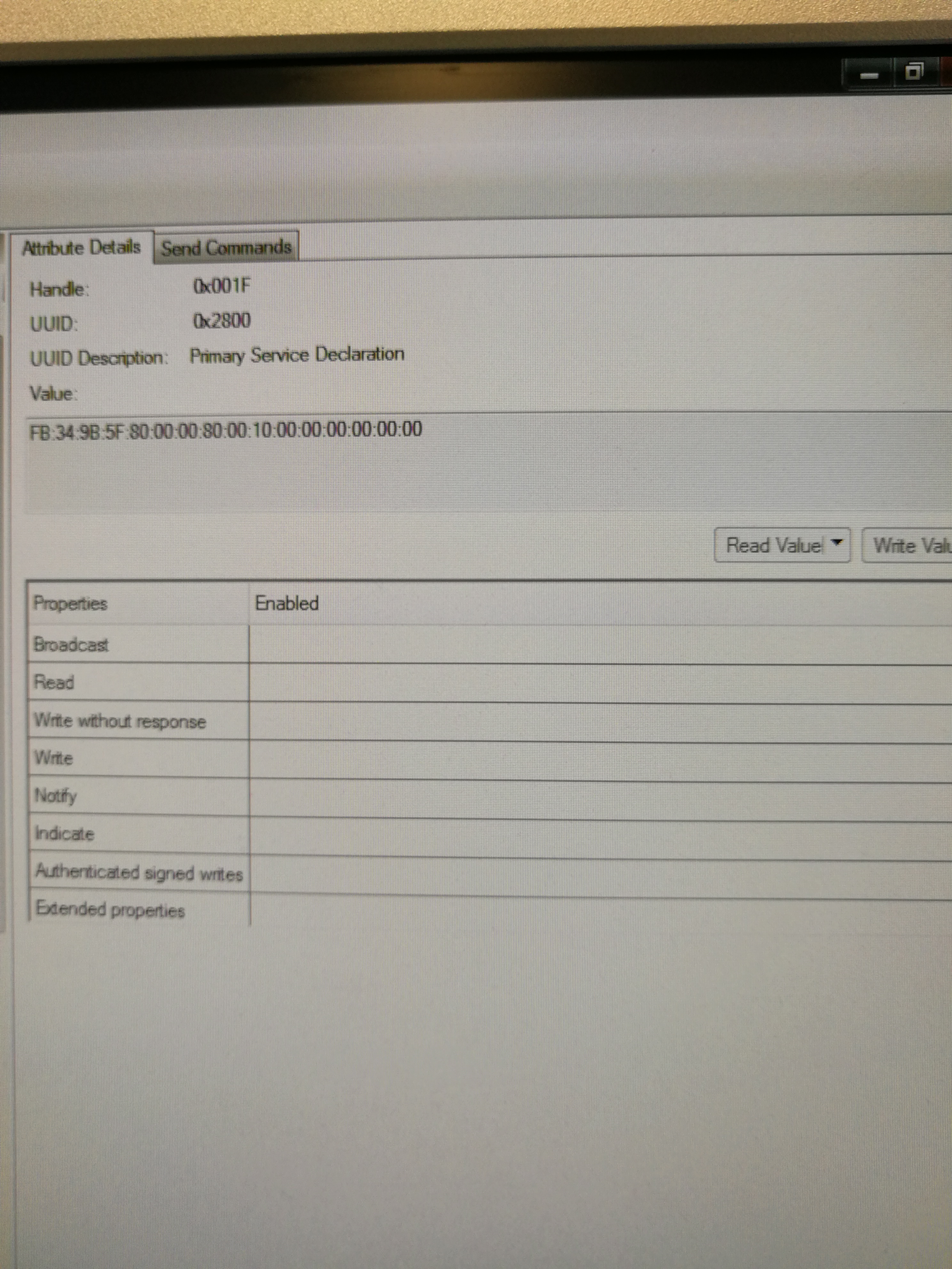

I have a sensor which is working is sending data via BLE and it has a 128 UUID bit service [0x 000000-000000-1000-8000-0080-5F9B34FB] image description
In order to do the discovery i should add it using sd_ble_uuid_vs_add () But I´ve problem there, in my code, the ble_uuid_t is not accepting me the .uuid, it gives me the follwing error: aggregate value used where an integer was expected.
static ble_uuid128_t  quatServ128uuidd= {{0xFB, 0x34, 0x9B, 0x5F, 0x80, 0x00,
                0x00, 0x80, 0x00, 0x10, 0x00, 0x00, 0x00, 0x00, 0x00, 0x00}};
static ble_uuid_t const QUAT_UUID_SERVICE =
	.uuid = (uint16_t) quatServ128uuidd,
	.type = BLE_UUID_TYPE_VENDOR_BEGIN
err_code = sd_ble_gattc_primary_services_discover(m_conn_handle, start_handle, &QUAT_UUID_SERVICE);
But In the ble_uuid_t I've problems to set it up.

  • As Turbo J explained, Nordic Soft Device runs (in the spirit of BT SIG) on 16-bit short UUIDs and 128-bit base UIDs during any GATT operation. So you will get structure of short 2-byte UUID value and reference to internal "table" of 16-byte UUID bases. By default Soft Device knows only BT SIG one and all the rest is treated as "unknown". If you know at start up which proprietary UUIDs you will use then you can provision them to the Soft Device (but you will need to remember which index is which). If not then you can either do it later during run-time or simply do this outside of Soft Device by reading full 128-bit UUID value by proper GATT commands (this is applicable for GATT Client only of course).
