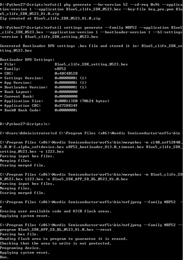

    I merge the four files(applicaiton,bootloader,softdevice,bootloader setting) into one file then program to the chip, I found that it stays at the bootloader and broadcast as "DfuTarg", not the application.At this time, if I do OTA and then close bluetooth function or close the APP to make a bad condition, bootloader wouldn't timeout even if I wait a long time. However, if I do OTA successfully, at this time it will run the application, not bootloader. Then I do OTA again and make a bad condition to test WDT, I found that the device reset when the WDT timout occurs.
    So it seems that I have found something. After I program merged file, it should run the application, not the bootloader. In fact, it runs the bootloader. So I think the main problem is how to make it run application when program it firstly. I use the same way for SDK V12.x, it wouldn't meet the problem and it would run the application first.
  • How are you generating the bootloader settings hex? Can you post the nrfutil command and the output in the terminal? Also can you debug your bootloader project after you have flashed the combined hex file and check if you reach the if (nrf_dfu_app_is_valid()) statement( line 197) in nrf_dfu.c in the function nrf_dfu_init(). If so what does nrf_dfu_app_is_valid() return?
