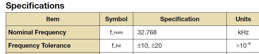

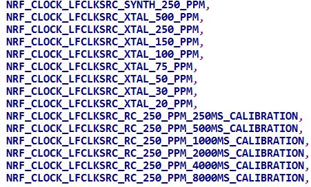

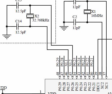

Hi, I'm using Nrf51822 to implement a RTC(200ms tick) I connect a external 16MHz crystal to the MCU. I use the S110 softdevice with BLE function enabled, so it's in ble_stack_init() where to setup the crystal, right?
My question is which crystal option should I select? (below table)
I once tried to use NRF_CLOCK_LFCLKSRC_XTAL_20_PPM, but I found that it seems a coule of seconds faster than the real time after a couple of hours...
Or am I suppose to use NRF_CLOCK_LFCLKSRC_SYNTH_250_PPM?image description
