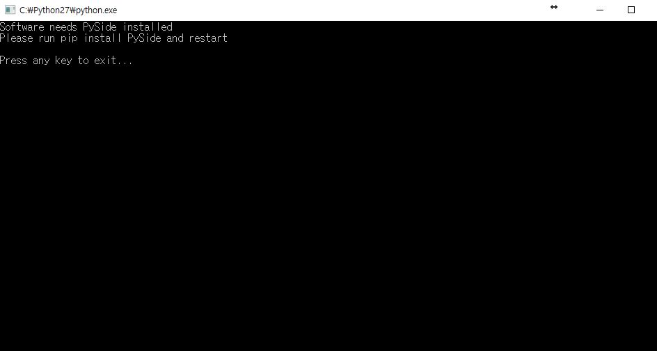

Hello. I have a problem as following
How to solve...??
Thank you.
How to solve...??
Thank you.
Hello Hyeongseok, Have you ever execute the python_packages.bat inside the software package ? That batch file will help you to install all the necessary package for PPK . Please double click the python_packages.bat :)
See here on how to install pip, then run python_packages.bat afterwards as Rick suggested.
Thank you for answer. I have a question one more. How to install pip...? where??
On the page I linked to under "Otherwise": Download get-pip.py
, and then run python get-pip.py
in the terminal to install pip.
