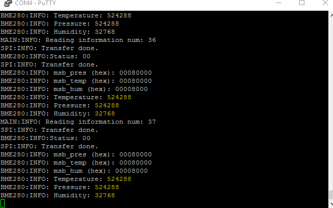

Hello, I have been trying to read the temp , hum and pressure value using BME280. The problem i face is i get the same value constantly and it doesn´t change.
I am trying to do the burst read and i can get RESET value but the data remains constant. image description
I tried to compensate the uncompressed value with the API provided by the BME280 datasheet.

I can attach my main file and BME20 driver . Any pointers will be appreciated .
