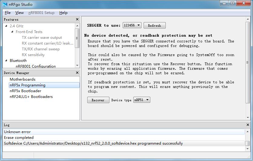

Hello, anybody!After when I download the protocol stack(S132).The target is NRF52832 chip,tool is J-link OB. image description
but,the softdevice sometimes can program and anytimes keil can debug.

Could it be that you are in SystemOFF? Have you tried using nrfjprog from the command line directly? Have you installed the latest nRF5x toolset? What kind of board do you have? Custom? nRF52 DK?
hi,my sdk is v11.0,SD is S132_nRF52_SoftDevice_2.0.1,the chip is no SystemOFF.I download tools is latest.but have no tryeid using nrfjpog command.
Are you working a custom board? If so what kind of programmer do you use?
Can you make sure that you have the latest version of the JLINK drivers, nRFgo Studio (1.21.2), and nrfjprog (v9.5.0 was released yesterday).

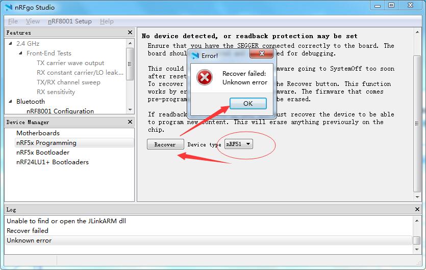

hi,Martin Børs-Lind!now I install the latest version of all software,when I open the nRFgo Studio to work,the software will crumbles. the question is JLinkARM.dll_unloaded...
Problem signature: Problem Event Name: APPCRASH Application Name: nRFgoStudio.exe Application Version: 0.0.0.0 Application Timestamp: 024232f0 Fault Module Name: JLinkARM.dll_unloaded Fault Module Version: 0.0.0.0 Fault Module Timestamp: 542a5cde Exception Code: c0000005 Exception Offset ...
Do you use a custom design with some sort of JLink OB chip on board or a development kit from us?
Can you please try to use nrfjprog?
