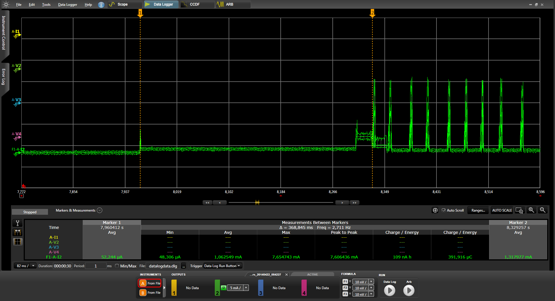

I have made some current and timing measurements on the nRF51822 Development Kit (connected to a nRFgo Starter Kit) running some of the example applications provided in the SDK (Power Profiling Application and Heart Rate application example), and I have noticed that there is a wake-up period of 350 msec consuming an average of 0.9 mA aprox. from System OFF mode to the start of advertising. Why is this period so long? How can it be reduced?
Thanks in advance
