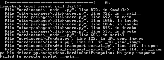

Hi, I'm having trouble performing a secure serial DFU with the nrf52 DK, I'm using the following components :
  • SDK 13.0.0 : experimental_bootloader_secure_serial example
  • softdevice v4.0.2
  • nrfutil v3.2.0(standalone exe)
I've disabled flowcontrol and reduced the baudrate to 9600 as suggested by this post. I still get no ping response error from nrfutil.
nrfutil error message nrfutil error message
rtt viewer log rtt viewer log
  • Could you post the nrfutil command you entered to start the serial DFU?
  • I had some issue with my com port, I could get it to work with flow control enabled and baud rate of 115200. But it does not work with flow control disabled and baud rate of 9600. I use the following command : nrfutil dfu serial -pkg dfu_test_app_hrm_s132.zip -p COM1 -fc 0 -b 9600
    I get TypeError: 'NoneType' object is not iterable on nrfutil.
  • I am able to reproduce this here and I get the same result if I try to perform serial DFu with flow control enabled (on both the nRF and PC side), but with the baudrate set to 9600. I have reported this to the developer and I will keep you posted.
  • Are there any updates on how i could use nrfutil with flow control disabled?
  • @srb0525: There has been some fixes in nrfutil v3.2.1 regarding serial DFU, see this link. Could you try to use this version and see if the issue has been resolved?
