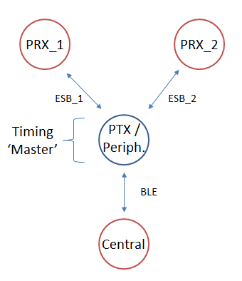

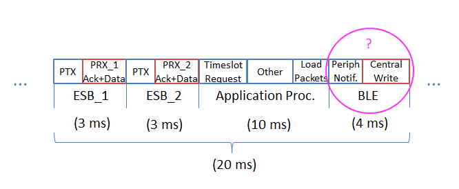

I have an application with hard real-time requirements (i.e. down to the clock cycle). My topology and desired timeline can be seen below. Concerning the timeline, I believe I will not have any issue guaranteeing interval-to-interval synchronization among PTX and PRX devices by using PTX packets as a timing beacon. Further, real-time can be achieved by verifying that ESB packet payloads and ACK retransmit attempts do not exceed the allocated time period.
However, I am wondering if it is possible to use BLE in the same way I intend to use ESB. Specifically, I would like the BLE peripheral (running S132) to be a timing master that the central (smartphone) syncs its write command 'ACKs' to. Otherwise, e.g. two +/-20ppm clocks could have a 40us/sec mismatch. Additionally, I would like the central to be able to send its write command in quick succession (e.g. pre-loaded packet configured to be sent at the link layer). Because the minimum transmit window for a BLE connection event is 1.25ms, I'm hoping both notification and write could be completed within 3-4ms. Assuming 20B payloads, is this possible?

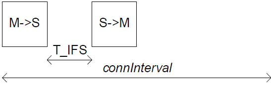

Edit: I did read the following from the BT v4.2 spec 6.B.4.5.1 "Connection Events", which leads me to believe I will need to the change the peripheral (BLE slave) and central (BLE master) roles in my topology in order to meet the requirements:
The start of a connection event is called an anchor point. At the anchor point, a master shall start to transmit a Data Channel PDU to the slave.
Figure 4.13 of 6.B.4.5.4 further illustrates the master initiating the connection event:
image description
T_IFS can be determined from 6.B.4.1:
The Inter Frame Space is designated “T_IFS” and shall be 150 μs.
Assuming max packet size of 37B (BLE 4.0 and 4.1) and 1Mbps throughput, that would result in a total connection event time of 2*(37*8) us + 150 us = 742us not including radio startup/shutdown. This answer confirms that calculation. Additionally, Section 16.3.3.4 of the SD 132 v4.1 spec gives a worst case send+receive central event processing of 250us (see calculation in document). Even though a fair amount of this processing may overlap with the 742us calculated above, we can add them together to get a conservative worst case estimate of about 742+250=992us overall, though there still could be some variability based on GATT/ATT/SMP SD operations. Therefore, a BLE central send+receive event should be able to occur well within the desired 3-4ms window, and perhaps even within 1ms.

    I doubt very much that you will be able to get the same timing accuracy over a BLE link as you can get with ESB.
    The problem with BLE is that you can't know for sure how much delay there will be between uploading a packet, and the packet being received on the other side. You might be able to estimate when the connection event occurs, but the BLE link layer don't provide any information about possible retransmits, so you don't really know the exact time at which your packet is sent and received.
    I think the most reliable solution would be to send a timing beacon at regular intervals from your timing master, over ESB, with retransmits disabled. For each timing beacon you can update the payload with accurate timing information, and if you send a bit more of them then you need then it should work fine even if the PRX's don't receive all the beacons (this has to be calculated based on the accuracy of your crystals, and the accuracy that you need).
