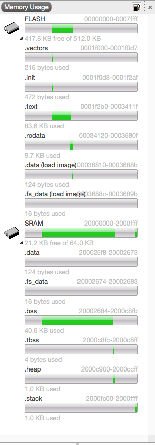

I have been working on integrating FDS into an SDK13 project using SES v3.24.
I'm not sure if the memory allocations are set correct. If I increase the FDS_VIRTUAL_PAGES from 3 to 100 I would have thought I would see increased .fs_data usage in the Memory Usage tab in SES for FLASH, in particular 100 pages at the end of the FLASH memory even though I haven't used them - I would have thought they would have been set aside.
Yet all I see is this:
image description
My flash_placement.xml is in line with the SES tutorial. My Section Placement Segments are :
FLASH RX 0x00000000 0x00080000
SRAM RWX 0x20000000 0x00010000
My Section Placement Macros are :
FLASH_START=0x1F000
SRAM_START=0x200025F8
I am linking in SD 132 4.0.2.
This is an nRF52832 QFAA chip.
Is this correct does anyone know?
